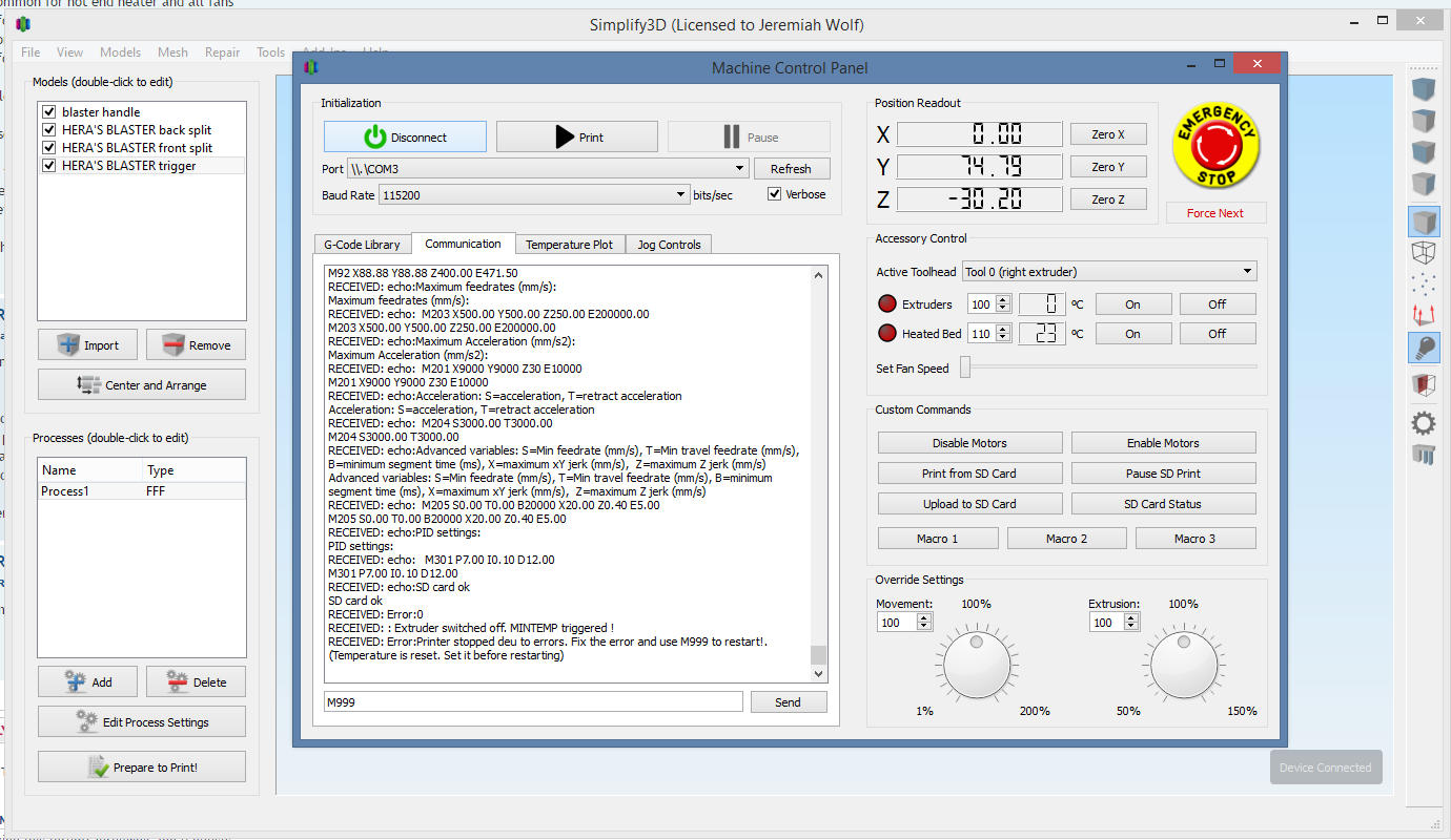

After going through a few failed prints, I'm assuming because of jammed extruder, I was attempting some "cold pulls" with Taulman 618.
After I reconnected, this MINTEMP error is what I got. So my extruder temp is stuck at zero. I haven't figured out how to fix it.
I re-installed the firmware and checked all of the wiring around the extruder for continuity(it was good), I have restarted S3D, restarted the printer.
When I pulled the filament the the hot end jerked a little bit, that why I thought there might be a loose wire.
I'm not sure what else to try....any ideas?

Almost certainly, that means the extruder thermistor has failed or become disconnected.
Unplug the thermistor at the extruder and measure the resistance from pin to pin. It should show about 100 kΩ resistance at room temperature: 135 kΩ in my cool basement, less in a hot room. If it's completely open or shorted, there's your problem.

I know very little about electronics, excuse my ignorance. I set my multimeter to the 200 ohm setting, and probed the molex connector on both sides and got nothing. Then I pulled the themistor from the heater block, I probed the end of the thermistor and one side of the molex connector and got nothing. Then I did the same thing with the other side of the molex connector and the reading was pretty stable around 1.2, which I'm assuming translates to 120.....
So as you said, the thermistor seems to be the problem, at least one of the wires.
