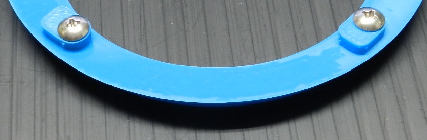

Printed out over 2000 parts in ABS in several colors for many manufacturers.
Some ABS is junk and hard to print with. Filamex blue glow and Makergear black ABS is the best so far.
Bed temp? seen no difference between 100 and 110.
Extruder temp 240 to 245 for the v3b.
1st layer speed at 50% to 60%
1st layer thickness at 140 to 150%
Infill at 20 to 25%, more than that and shrink issues distort the model/print.
Make sure the skirt, or brim get 2 layers to get the flow going good.
Blue_rings 002.jpg (68.45 KiB) Viewed 15092 times
Above pic shows almost perfect glass-like adhesion
Adhesion agent? Aquanet Unscented in the spray can over glass. Deal with this is, put some on, then
put some more on. I'll get 20 to 30 builds before cleaning the glass. I just dust the surface after
each print and lightly knock the high spots of with a 3" razor scraper.
Room must be warm, free from drafts, or build an enclosure out of cardboard boxes.
Bed must be absolutely level, seen a .003 low hurt adhesion, This gets more important
the larger the size, or how much of the build bed you're using. I use close to 10" printing
out 2 rings at a time. If you're just using the center, a bed slightly not leveled perfectly
doesn't seem to bother the prints from sticking.
ABS is a good reasonably priced filament to print with, but it does present challenges if
compared to PLA or PET+.
