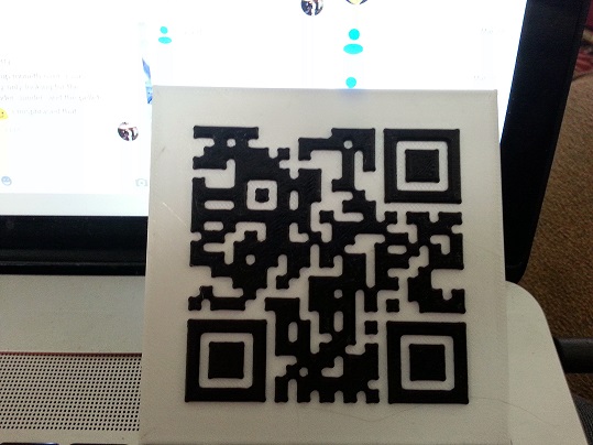

I have set out on a quest to print QR codes. I have found a few areas where there is demand for printed QR codes, so I am gonna tackle this project. I was wondering if anyone here has attempted this and what their results where. I am going to be experimenting with them over the next few weeks and posting my results here. I did an initial print last night with the standard M2 settings (I use S3D). See the image attached. For scale, this is 2.75" square. Some of the QR code blocks did not receive a solid infill. Now I am going to work through the settings to achieve a solid surface print. Feel free to comment...would love to hear successes and failures, will help me in my quest.

Can you zip and post your .STL? I think i may have an idea on how to insist on Slic3r to infil this area...

mharter wrote:Some of the QR code blocks did not receive a solid infill
If at all possible, set the "pixel" dimensions to an even integer multiple of the thread width, so the slicer can exactly fill the space. Some slicers can do variable-width fill, but picking the right geometry helps a lot.
The smallest possible pixel will be a 2x2 thread square. Right now, they're are about 4.75 threads wide: two threads around the perimeter plus nearly one thread width unfilled down the middle.
You should also calibrate the Extrusion Multiplier value, because the threads on the top surface of the background don't quite fuse together:
viewtopic.php?t=1964&p=9180
Re: Printing QR codes
Post by jimc » Tue Mar 24, 2015 1:23 pm
when doing text or anything like this use 1 perimeter. this way you will get solid infill in all the areas.

Matt_Sharkey wrote:Can you zip and post your .STL? I think i may have an idea on how to insist on Slic3r to infil this area...
I don't have the file with me...it is on my home workstation. I will do this once I get home.
Edit: I have Simplify3D, not Slic3r. I might take a look at this, but will still send you the file after work. Would like to check out how Slic3r works.
I noticed the surface separation...gonna run a calibration routine this evening when I get home. Once I get it calibrated then I can better scale the QR code so it is proportional to the width of the thread.
