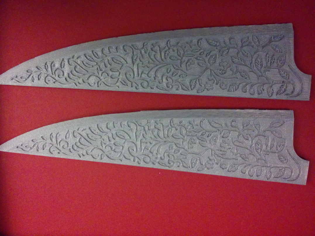

You could of course go for a smaller nozzle. The smaller the nozzle the thinner the wall, the more detail you technically can print. However as a rule the smaller the nozzle the more tweaking you will need to do with bed height tuning and leveling - small details = bigger issues when things are off.
I am currently printing a vorpal blade which has a great deal of detail in the blade and handle. At default settings for a .4mm nozzle I lose quite a lot of it. I am going to give it another shot tonight with my .25 mm nozzle and will post a comparison when/if I get a successful print.

Here are the first results - 25mm on top - 40mm on bottom. You can see that a lot more detail was picked out on the 25mm. It also healed a few holes that were in the 40mm owing to the slicer being unable to squeeze an infil into the small area.
If I print again I will probably do more than 4 top/bottom layers. With a very fine nozzle its sometimes hard to get a nice solid surface - especially with the way this slices ... very strange.
I will say - your print bed had better be VERY level for this and I would not recommend this on a lesser built printer. Very small infil = very large shake.
Now I need to print the handle in bronze and we will have a finished weapon.

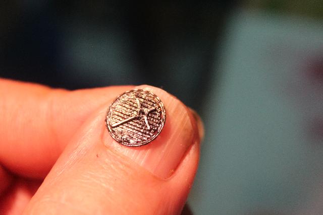

Bratag, I would say those are amazing results! Is that PLA or ABS? If your using S3D could you shoot me the settings you used? I down loaded a simple medallion from Thingverse yesterday and experimented with sizing the object. I was able to get down to a size less than a dime where the cross on the medallion still showed. I was quite surprised that the detail came out with the .35 nozzle!
Hopefully I'll be able to upload a picture of the "button" today.

Silver PLA. ABS and I have a hate hate relationship and I much prefer PET+ for those parts that need higher heat tolerance and strength with flexibility - my extruder etc are all printed in PET+).
I am at work right now but will share my FFF when I get home. Basically I print a little hotter, have the bed a little warmer (I want the small parts to lay down on the first layer and a little extra heat helps.) I print the first layer at 100% instead of my normal 90% and I drop that first layer speed - WAY down. The overall speed I drop by about 25%. Its a longer print but little parts need that slower speed.

Nice pictures, huge difference! Thanks for sharing them.
