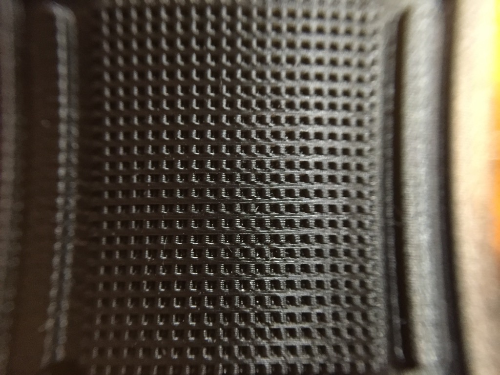

Guys, I have a challenge and a question :lol:
In the link below you find:
  • A picture of a small object. The top of that object has a grid. The grid is 0.5mm ^ 3. When I print this object, the grid is not open but filled, as you can see in the picture:
  • The settings I used in Cura, I've also tried to Slic3 with a but the same result
  • The .stl file if you wanna give it a try ;)
http://1drv.ms/1NmgCNJ
Is it possible to print such a fine grid and how do I get the best result?

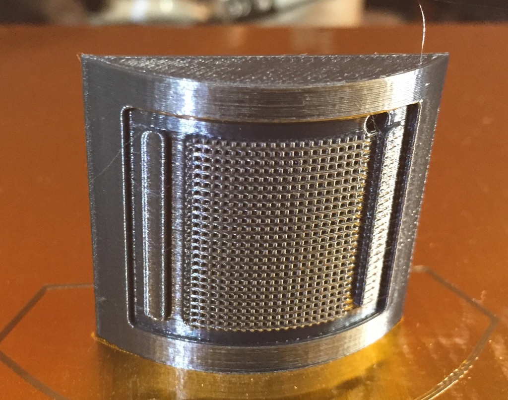

Post by jsc » Sat Apr 11, 2015 5:15 am
ednisley wrote:Alas, that won't work, because the nozzle can't draw those little 0.5 mm "square" protrusions on each layer. It might come heartbreakingly close with a 0.25 mm thread width, but ...
You'd think that, but:

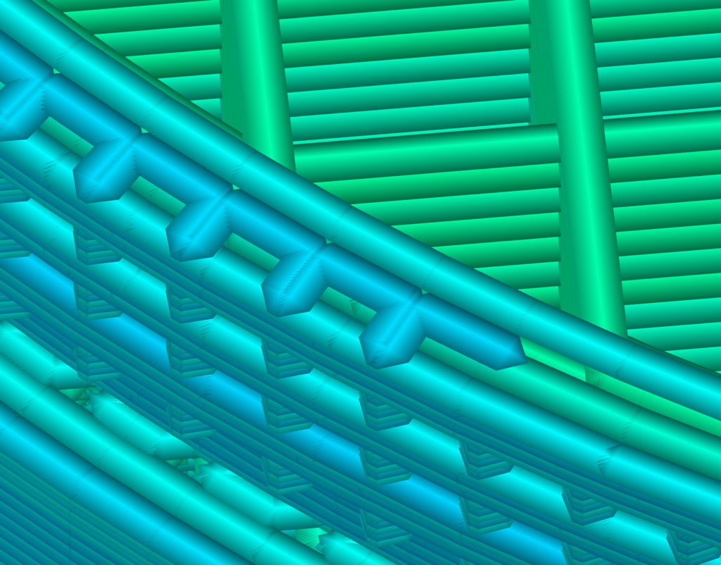

Here's what the slicer is doing to it:
Here's a macro shot of the holes:
(What is this thing, anyway?)

Post by jsc » Sat Apr 11, 2015 6:10 am
I had a flashlight raking across it to bring out some detail.

Post by DIY3D » Sat Apr 11, 2015 12:01 pm
Hi All,
@Ed
That was exactly what I thought, I couldn't imagine how that should works, anyway thanks for the reply!.
@jcs
Great result and clear photo's :o !
I have made a testprint and you're right, that looks much better then my first attempt:
http://1drv.ms/1yfgHvu
Thank you for trying out, it's the top part of a press mold.

Post by ednisley » Sat Apr 11, 2015 2:05 pm
jsc wrote:You'd think that
And, indeed, I did! I saw bumps, not dents... [sigh]
Just to show how wrong I was, subtract that thing from a rectangular solid and print the resulting bumps emerging from a concave arc. They're small enough that overhang droop might not be a problem.
It looks like the difference between hole and wall widths depends critically on the printer setup, but at least it's possible to get close to the goal: your printer produces wider walls, Marco's generates wider holes.
Well done!
Re: Challenge
Post by jsc » Sat Apr 11, 2015 5:45 pm
It looks to my eye like the walls are thinner than the holes, so I think the inverse object would print out okay.
I understand your argument, but it seems like the slicer is doing interesting things to invalidate it. Maybe backtracking with half extrusion? Wonder what Cura or slic3r does with it.
