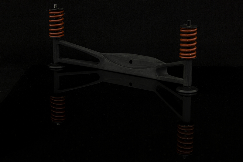

- Clock base, a motorcycle brake rotor will sit on top and act as the clock face. I have a piston that will support the rotor from the back. Had to rotate the object at an angle to fit on build plate.

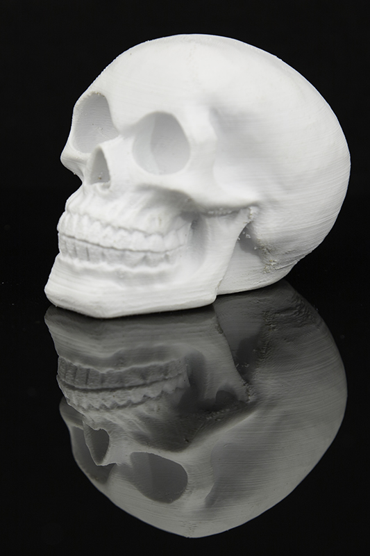

- Skull straight off the printer, .1mm resolution, 100% infill

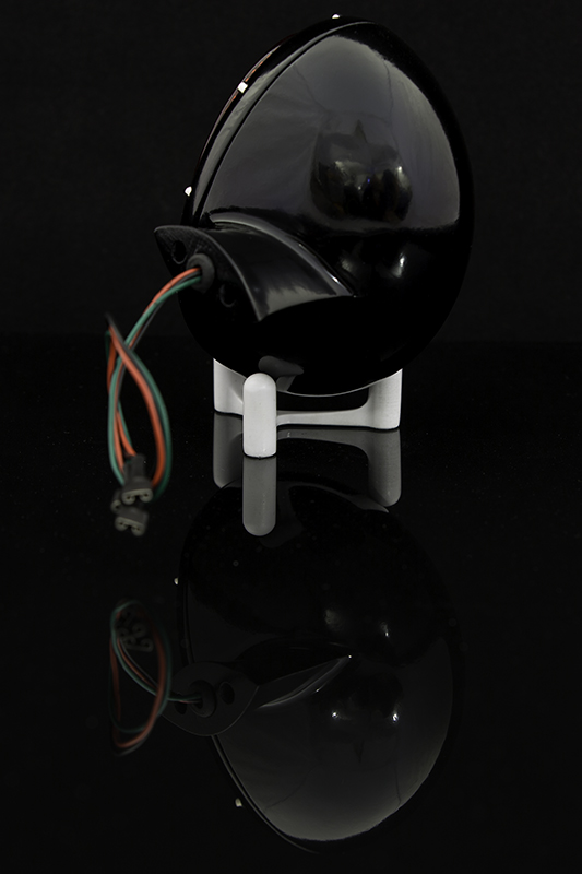

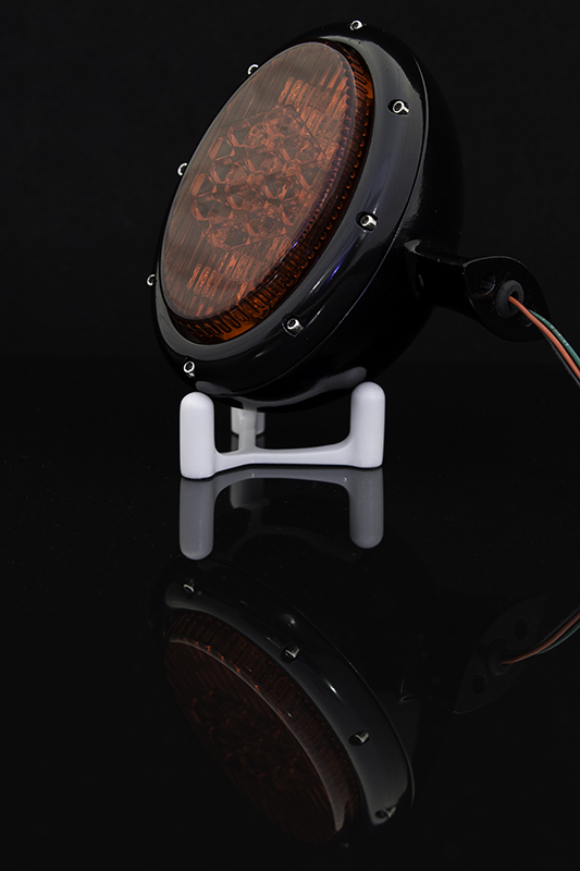

- Taillight housing, printed in ABS and seems to hold up pretty well on the car. I've driven about 100 miles over pretty rough roads with no signs of damage.

How was your ABS taillight housing finished?
A note on the skull: 100% infill is rarely useful, unless you need the most rigidity. Check out this very interesting study: http://my3dmatter.com/influence-infill- ... t-pattern/ Yield stress tops out at 90%, and surface quality drops off at 100%.

Thank you both. I modeled the taillight and clock base. The skull was off of thingiverse, I think it was this one: http://www.thingiverse.com/thing:168602. The clock base was done in Onshape.
The taillight housing was done in 3dsmax as Onshape doesn't have an ellipse tool. After about the 3rd alteration I was really missing the flexibility of CAD. I'll have to try Fusion 360. I assume it's not cloud based like Onshape is? I like the convenience of cloud software and it'll be nice when they get their Android version up and running but there have been occasions where my internet connection was effectively non-existant.
As far as finishing on the taillight, it was printed at .2mm layer height with a 30% infill. I sanded with 150 grit, then 320 grit, sprayed with a filler primer and then rattle canned them black with Rustoleum. The surface finish is far from perfect but I don't have a good place to paint (I need to convince the wife to let me turn one of the kids bedrooms into a spray booth). I did try other finishing techniques. I placed the part in a can with some acetone for a while but wasn't happy with the finish. I also tried Rustoleum Triple Thick Glaze which was mentioned in this thread: viewtopic.php?f=3&t=1000. The glaze has Acetone in it and it looked great, but it didn't completely smooth it out and I wasn't sure how it'd hold up on a car out in the elements.
I printed the skull at 100% because I wasn't sure how I wanted to mount it to the shifter so I wanted to make sure that wherever I drilled I was drilling into solid plastic. But I have printed other brackets at 100%, I'll have to reduce that to 90% in the future, thanks for the tip!

For finishing ABS, you can try the potentially explosive technique of getting a large jar and using your heated bed to take it up to 100C to get acetone vapor. A slightly safer method would be to use an ultrasonic transducer from a humidifier to generate the vapor: http://www.3ders.org/articles/20150509- ... parts.html. But I've mostly given up on ABS, and it was always really difficult to get consistent results with acetone. A little too long and everything looks too melted. I've been having good results with XTC-3D, a two-part epoxy that's marketed for 3D printing. I use it like you would use high fill primer, but easier to apply (for me) since you don't have to go out every five minutes to shake the can for another minute and apply another coat. Sands very well, too, but you will want to paint over it once sanded. Sturdier than primer.

I tried a covered coffee can with a thin layer of acetone on the bottom sitting on the stove with the oven on warm. There was just enough heat coming out the top of the oven to turn the acetone to vapor, but it didn't appear to be doing much, then the next time I checked it looked melted like you mentioned. I built a rotisserie for painting wire wheels that I'd like to attach a can to and try making a tumbler. I also have a sand blaster but it's not in a cabinet so the media gets everywhere. I really dislike hand sanding, I know it's inevitible but the less I have to do, the better.
