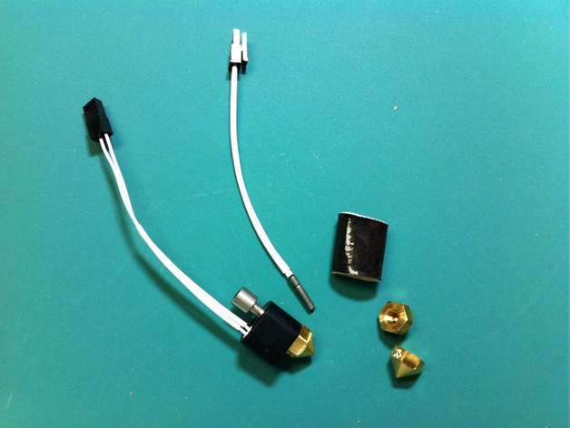

You would just retract the filament first to get the plastic out of the way, and if it's stuck, it's a lot easier to reach in and cut it on the V4 design. Let it cool, take the hotend out, and then I imagine that an 11mm wrench and a padded vise of some sort will be required to remove the nozzle. I checked mine and it is some kind of tight!. (Must have some junior Samsons assembling these things!) ROFL!
This is what the replacement hotend and nozzles look like when they are not on the machine - looks like you just screw the nozzle off of the barrel, being careful to not damage the heater block. (And i do know that you have to be very careful to not damage that long neck at the top - it bends very easily, so grab it by the block.)

Remember that everything expands when hot, so the nozzle should, in fact, be removed and assembled (carefully!) while hot, preferably at the top of the range the hot-end can handle. If you tighten it while cold, it is likely to be loose when hot, and if it has been assembled hot, then you are going to find it extremely hard to move when cold. Give it a firm, but not over-tight, fit when you assemble it hot, and it should be good.
The trick is to get the hot end free of the rest of the machine and then heat it up while it's dangling in the air, and not have it run into anything it can melt (including you). Also, there's the complication that as soon as you clamp down on it with a pair of pliers, the pliers are going to be a giant heat sink, and it's going to get a lot cooler quickly.
