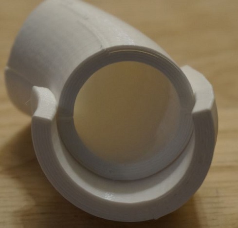

Here's a print that just came off the bed. No adjustment of any kind. There are three parts that had to fit together: the inner cylinder is in two parts, and the outer shell snaps around and holds them together. The curves on this thing are funky. Each piece bends in all 3 dimensions (more mold making fun
I'll tack on the factory file for this print, but you always have to adjust things like layer height, infill and print speed to whatever you're printing at the moment.

Here's a print that just came off the bed. No adjustment of any kind. There are three parts that had to fit together: the inner cylinder is in two parts, and the outer shell snaps around and holds them together. The curves on this thing are funky. Each piece bends in all 3 dimensions (more mold making fun).
