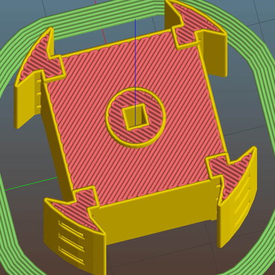

This pillar fits inside a stack of hard drive platters and holds four LED strips:
Hard drive mood light central pillar - angled slots for LED strips
The OD is 25 mm and the strips are 12 mm wide, so there's not much room for the four mushroom shapes that support the platters. Two perimeter threads choked off all the infill, so I had to go with one. The usual 15% 3D Honeycomb infill provides enough strength, but I wouldn't want to use it for anything structural!
