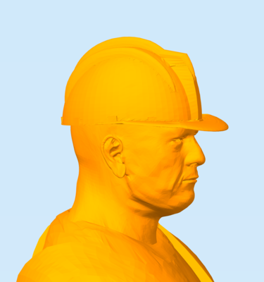

Hey guys, thanks for the replies. here are a few shots- first one is the basic white strong and flexible
![Image](http://martinsant.net/wp-content/uploads/2014/10/MD-P1040117.png)
This one is the ultra-
![Image](http://martinsant.net/wp-content/uploads/2015/01/tablet-close.png)
If I could get to the res in the first that would be ok.
I've never actually used a 3D printer, (although I do have a 3D router). I just have had various services print them.
Re: M2 vs Shapeways?
We need a US coin of some sort near those prints to determine how good or bad they turned out.
Hmm. How about a pencil?
![Image](http://martinsant.net/wp-content/uploads/2015/02/crew-700px.png)
![Image](http://martinsant.net/wp-content/uploads/2015/04/3guys.png)
1:20 scale, 1:24, and 1:29. 1:29 is about 2.25 inches (more or less) tall. He's also frosted ultra. The blue guy with the tablet in the previous post is the same size.
I have source files online too in stl format if that helps-
http://martinsant.net/3dprint/
Thanks for looking- I appreciate it.
That Shapeways process uses laser-sintered plastic powder, which means that it doesn't require additional supports: the unsintered powder holds up the lower surfaces of the sintered part.martan3d wrote:While they are ok, the face detail could be better.
The M2, as with all fused filament printers, requires support structures under (most of) the downward-facing surfaces, like those chins, noses, arms, and helmets, to prevent drooping. After printing, you must separate the support material from the object and, in general, clean up the resulting surface damage; that's more difficult with smaller features. You'll find Perfect Masters of surface finishing around here, but it's a manual operation requiring both skill and patience.
If the facial detail in the first picture is "acceptable", then you'll probably be satisfied with a fused filament printer. The details will look different, but not much worse than what you have. However, if that level of detail is "just barely acceptable", then a fused filament printer definitely won't fill your world with rainbows.

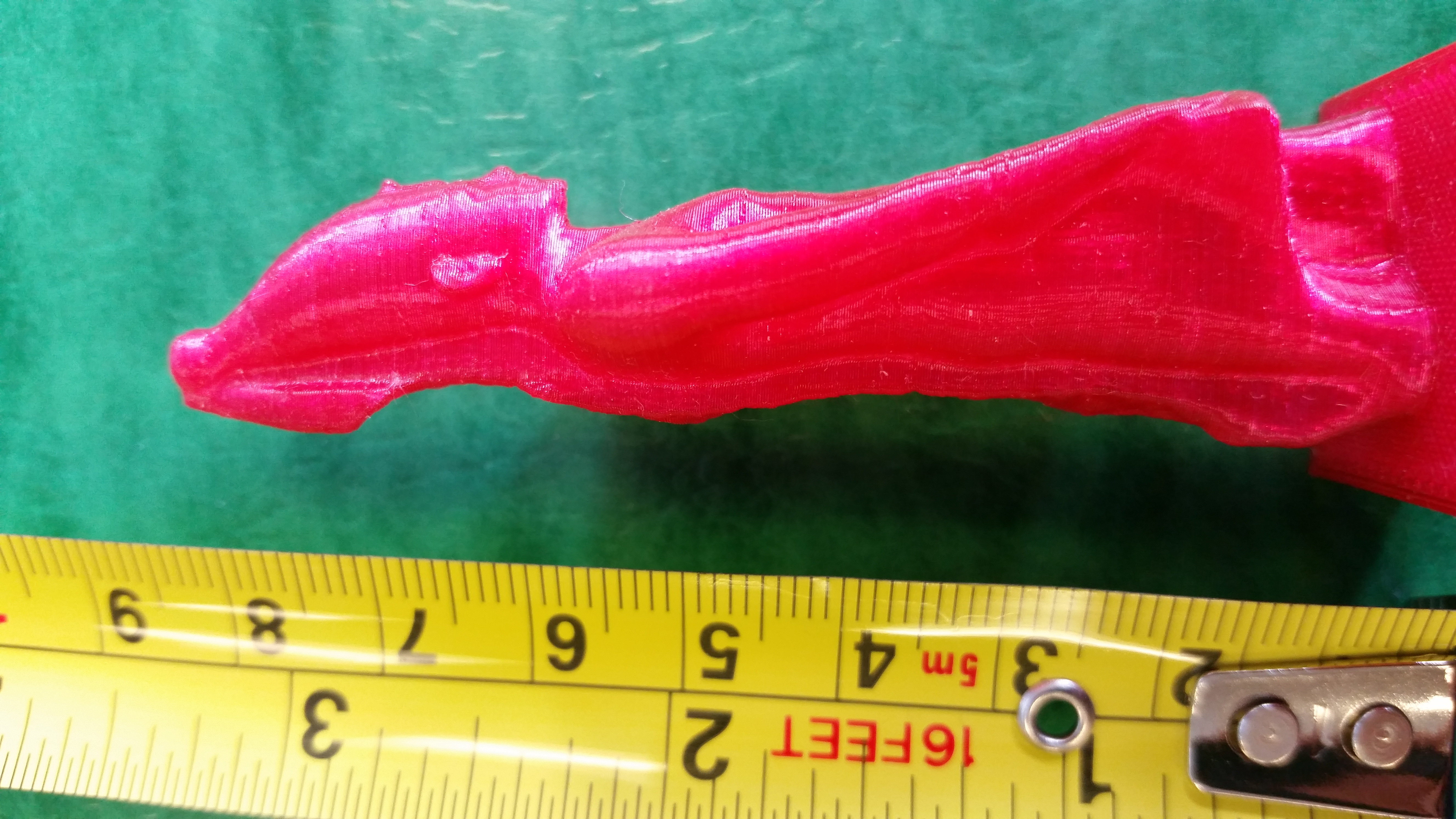

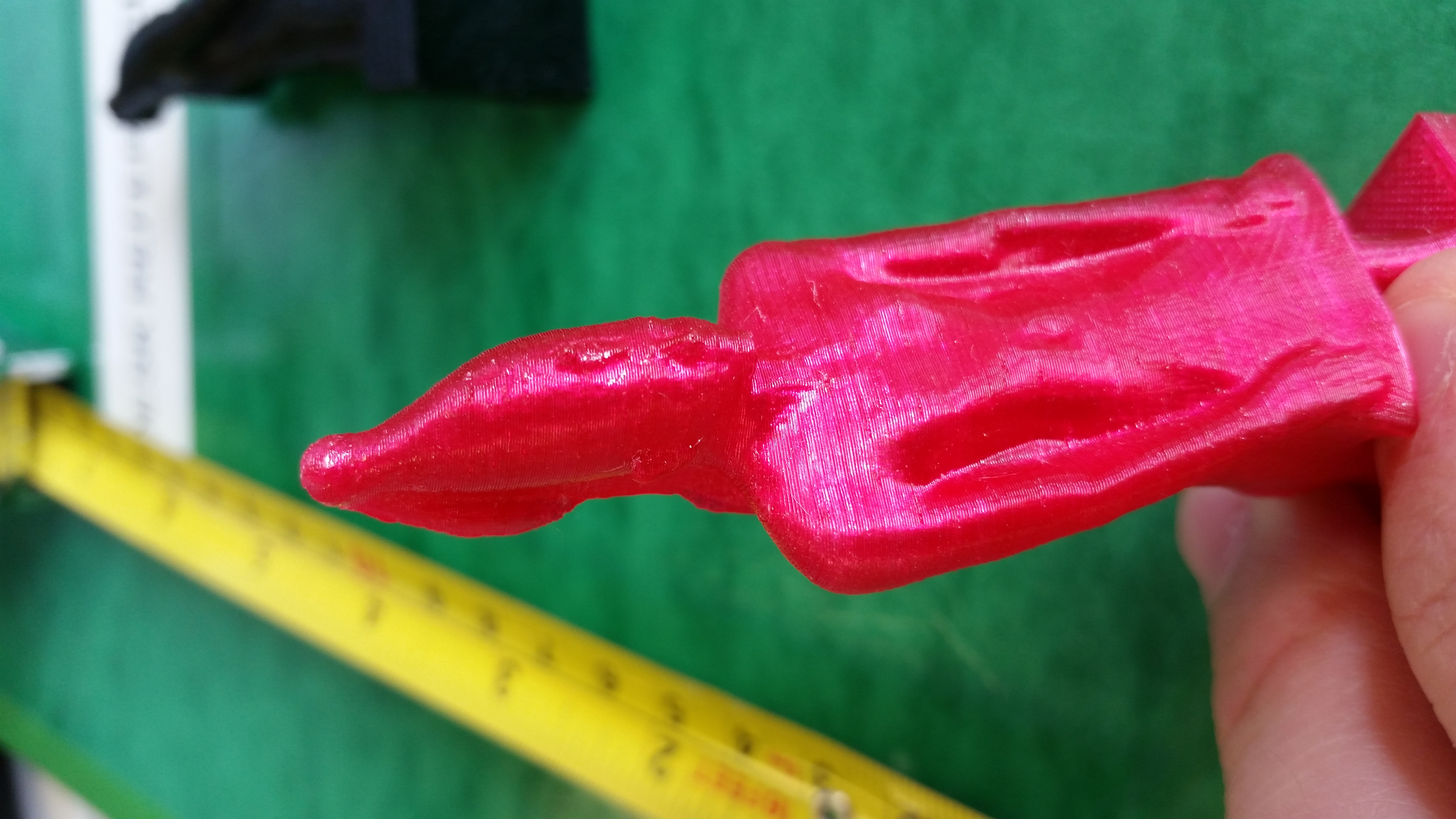

I happen to have a couple of little guys around that same size - in this case about 3.25 inches. Printed with .35mm nozzle and .16mm layer height (I think - might be .2mm or .24, I'm don't recall for sure). esun petg in translucent red.
The models is a repaired version of an 18th dynasty pharaoh in red granite. In this case, S3d auto-generated supports under pharaoh's skirt and between his chest and chin - the latter popped right off without a blemish.

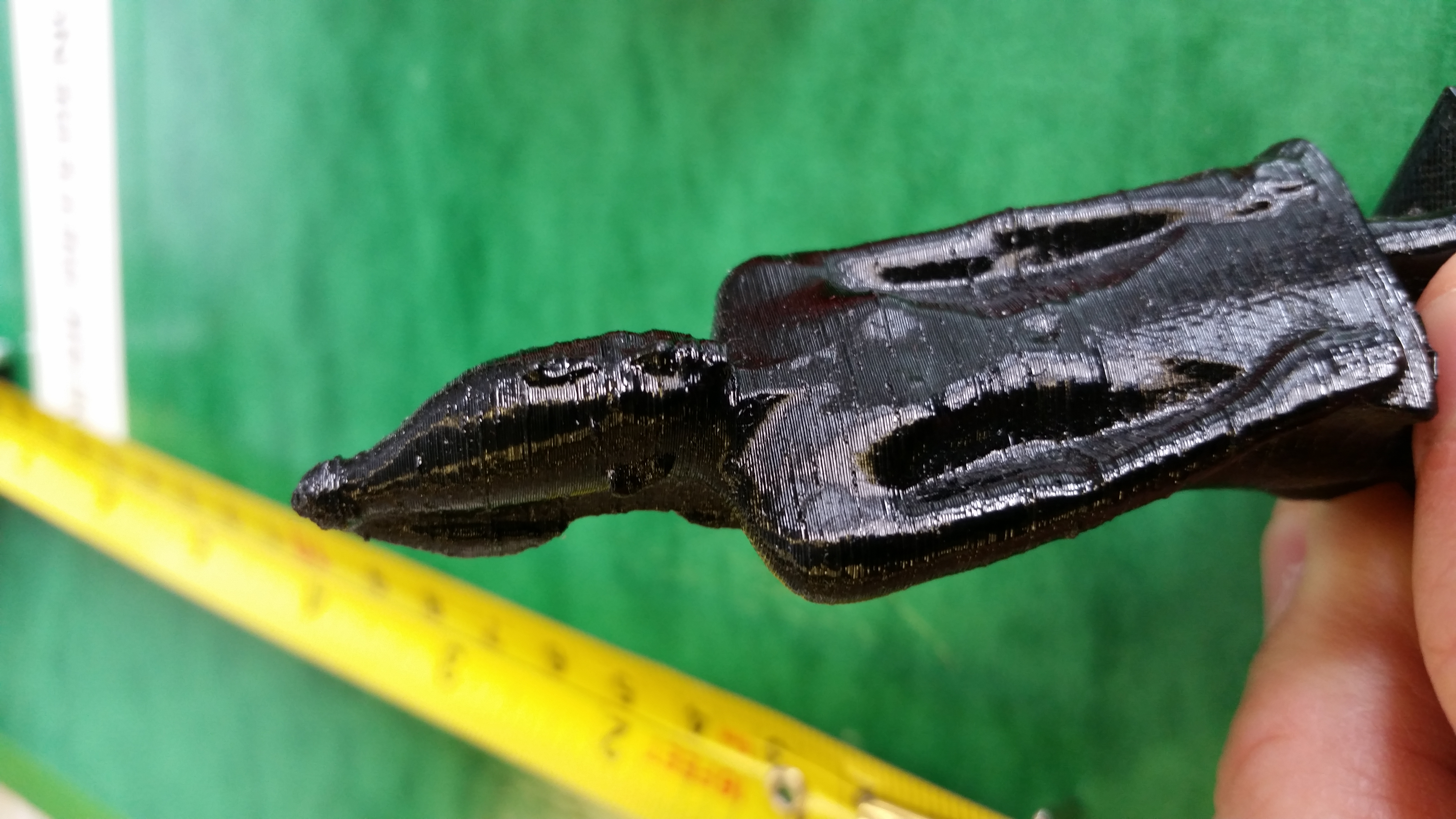

Unfortunately, the details are a little difficult to see due to the material. It might give an idea of what you'll get, however. I have one in opaque black, but unfortunately he suffers from some surface quality issues stemming (I think) from me forgetting to update the filament diameter after changing colors:
He cold be worse, though.
