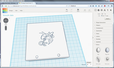

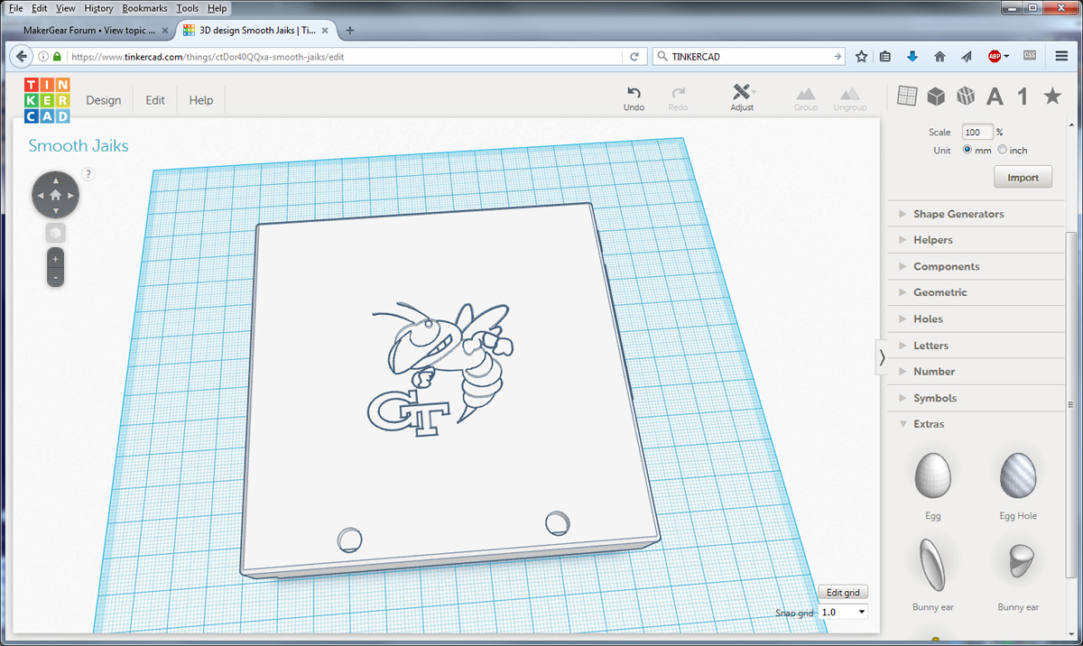

You can do the simple cut out in tinkercad. (see example)
(sorry for the quick run through here I'm a little busy at the moment but here's the cliff note version.)
Import both stl's and lay them out how you want.
Select the emblem stl and then click hole feature in the inspector window.
Now hold shift and select both stls and then click group up top. It should cut the emblem out.
The way I did it the emblem doesn't get cut out through the entire part because this would leave unconnected parts. (it would be easier to make the emblem a complete cut out and then you can change the colors of the printed emblem inlet.)
I'm not sure how it would print with or without supports in those cutouts the way I did it and I'm also not sure how hard it would be to inlet the actual printed emblem afterwards.... but this is just one way to do it there might be better ways.
Edit - I didn't see the other stl, it is cut out better but not completely enough.

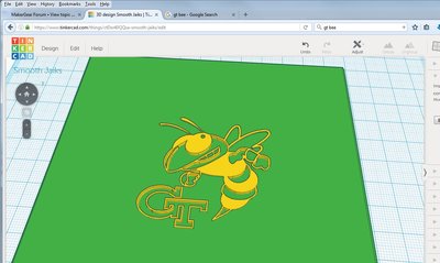

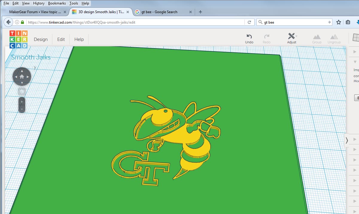

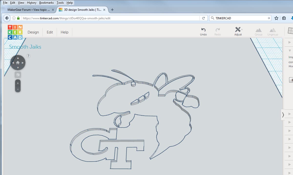

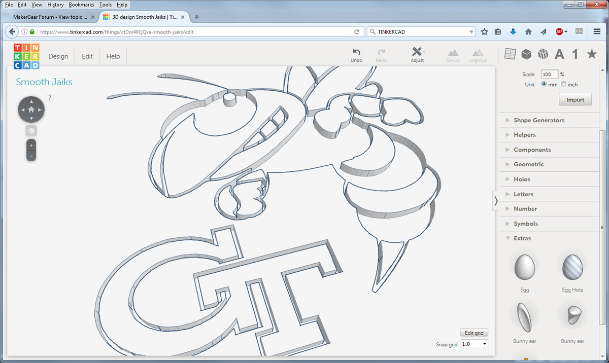

Re: Combining .STL files
This is how the cutout would look using the correct stl.
With the insert as provided.
It might look a little weird as some areas a recessed were others are not. If you did a full outline cut out instead you could easily do a two color insert (using a color change) and it might look better over all.

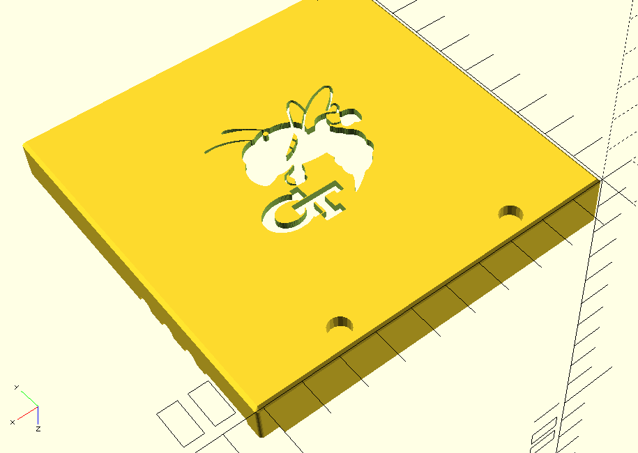

Here's a slightly different solution for you using OpenSCAD:
Produces this:
How did you create the original STLs? Kisslicer indicates some mesh errors. I tried to export the final result to attach here but OpenSCAD threw an error when rendering.
