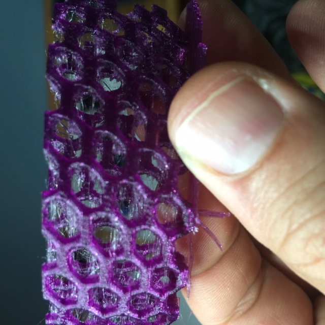

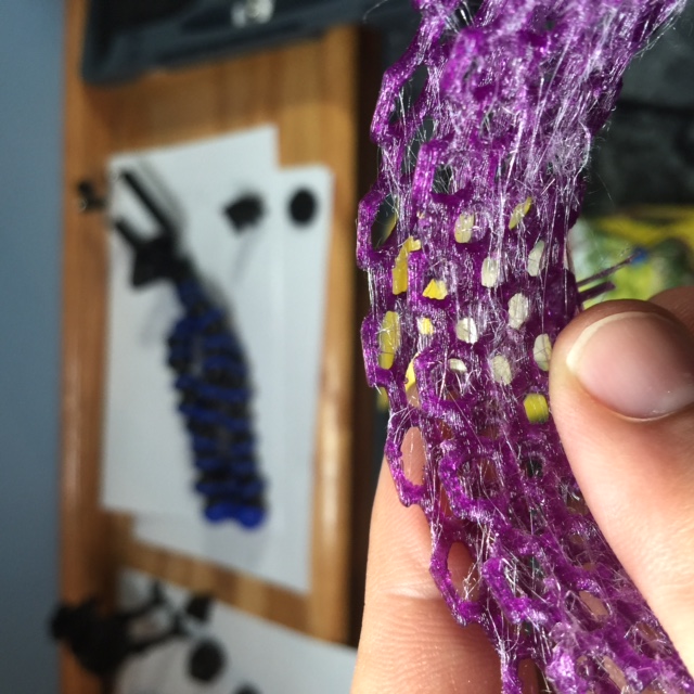

Post by outofmayo » Fri May 29, 2015 2:58 am
The calibrations definitely have improved my prints. I still have a bit of a hard time with really fine detail on tiny structures which I suspect might be simply a limitation of extruder based FDM. The attached pictures are from an attempted bracelet print in which a lot of stringing occurred. Otherwise it was looking really good until a connection failure happened at a single build point that propagated into a defect for which I aborted the print.

Post by jsc » Fri May 29, 2015 3:51 am
Stringing like that is excessive. What temperature are you printing at, and what do you have retraction set to? Try 1.2mm retraction and 220-225C for PLA. If you are already at 1.2 or higher, unscrew the fan, remove the filament drive, and see if the filament drive gear is loose on the stepper motor axle. Tighten the set screw if it is.
