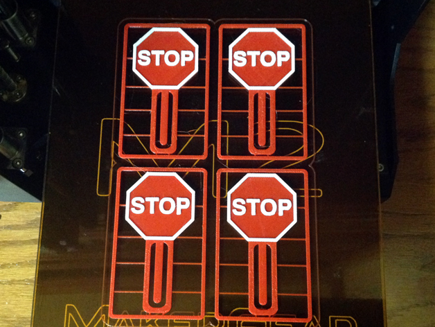

stop sign bookmark1.jpg (286.23 KiB) Viewed 63695 times
WooHoo! This totally works!......Check out the little Stop Sign bookmarks I worked up for the nephews' Christmas stockings.......
Nyah! Nyah! Nyah! Nyah!
I printed two colors with one nozzle......
I printed two colors with one nozzle...... :P
One thing i was noticing as I was trying to make these work....you definitely need to make sure you have a solid layer underneath the layer that you start the color change on, and another thing that puzzled me - when the switched-out color started printing, it didn't extrude for a while (few inches) before it kicked in. Not that there was any red coming out either - nothing was extruding.
Tried adding a little E2 code to squirt out a couple of mm, it just spit that out and then stopped extruding for a couple of inches.
Curioser and curioser!
Anyway, it's a funtastic development Steve - many thanks for posting the instructions! :D :D :D

Jules wrote:One thing i was noticing as I was trying to make these work....you definitely need to make sure you have a solid layer underneath the layer that you start the color change on, and another thing that puzzled me - when the switched-out color started printing, it didn't extrude for a while (few inches) before it kicked in. Not that there was any red coming out either - nothing was extruding.

BTW - Those Stop sign bookmarks look great. :D

Thanks! I'll be posting it on Thingie later .... :)
