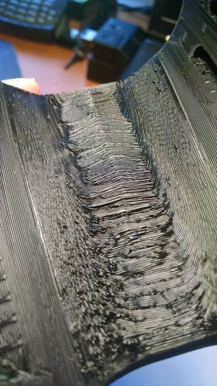

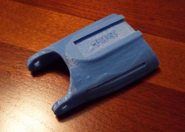

I reprinted this with a "process" layer for the problem area. I configured the outline shells set to 100 so there would be no infill in that area and also reduced speed a about 25% as well as set the supports as "insta" suggested. As can be seen from the picture it is much better, indicating that the way the slicer (S3D) handles this kind of situation could be better. I'm not even sure which setting is effecting the bottom of a suspended horizontal section (is it "bottom" or "Exterior Infill"?). Some other slicers may do better or perhaps there is some way to configure just this condition. My guess is that this is an infill problem. The print time increased to about 12 hours (I think it was 4 last time), not sure why as going from 35% to 100% fill for a few MM should not make so much difference.
So for now I consider this "closed", but if there are ideas for better handling of horizontal supported areas, let me know. And, thanks for the help!
Better

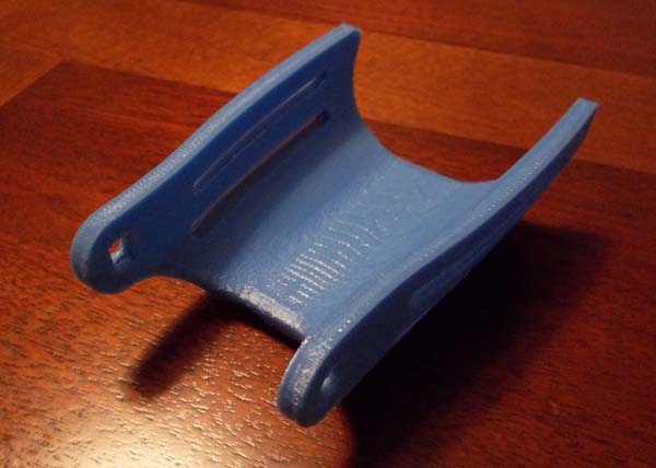

Crappy pictures... but as suggested I tried the gauntlet upside down with S3d supports and overall I think it came out mush better. It still has some zits and things but that's probably just my ooze setting and such.

jsc: I noted your infill is lengthwise where as mine is angled - that may have helped. It still looks like the layer is not fully filled, it is probably good enough but I'm trying to understand what is going on. Do you know why yours looks better than mine?
sthone: that does look very good - I always get a very rough surface over the supports, yours seem to have come out much smoother than mine ever have. I was tying to keep the top nice. In fact, your entire print looks smoother.

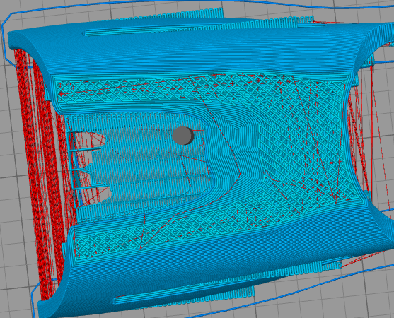

I don't know why your angles would be any different. The bottom layer infill takes the same direction regardless of the print orientation, because it treats each terrace as a bridge (contrary to some of my earlier statements). You can see what it's doing in the gcode preview:
The blue indicates a slower speed, which means it's trying to bridge. It's taking the shortest path, which is generally vertical. Does your preview look like that?
What do you mean by it doesn't look fully filled? You mean you can see gaps between the threads? That happens when you do any bridging, the lowest layer doesn't usually get pulled completely taut so ends up a little loose. In fact, I purposely set my bridging extrusion rate lower, which in theory should make the bridge tighter, but also makes it less "full". It's all tradeoffs.

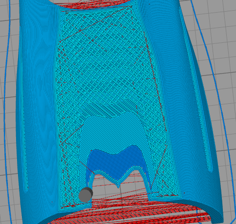

With S3D Supports- rectilinear
[quote="jsc"]The blue indicates a slower speed, which means it's trying to bridge. It's taking the shortest path, which is generally vertical. Does your preview look like that?
quote]
Yes and no. When I print without supports it shows the bridge speeds. With S3D supports it does not - your original assumption.

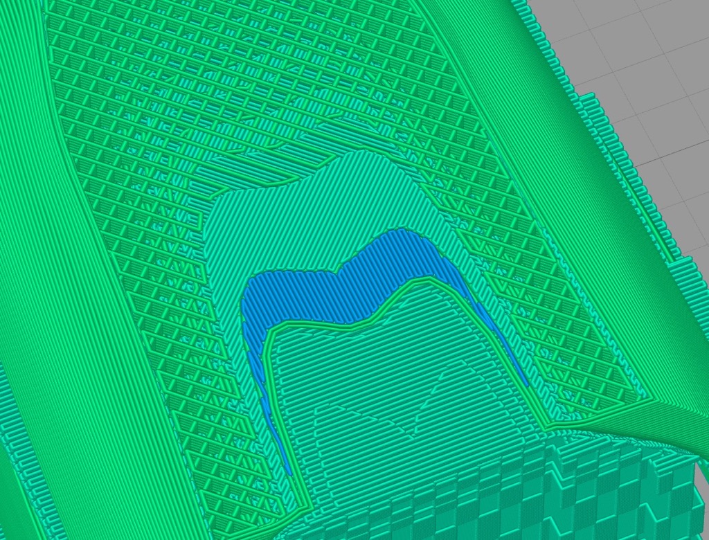

With S3D Supports @ 90 degrees - no bridge speed.
I don't see any way to control the layer over a support.
I also note the direction of the supports changes with the direction of the print on the build plate and there is no way to change this, an active topic on the S3D forum.

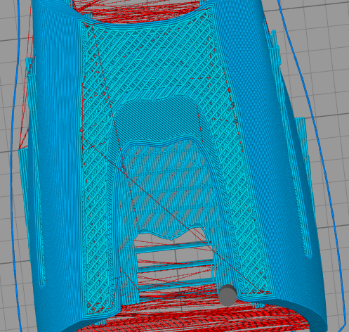

This is a bridge (without supports)- it would never work this way:
Without supports
