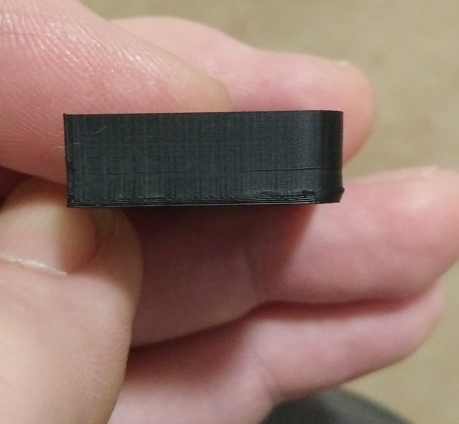

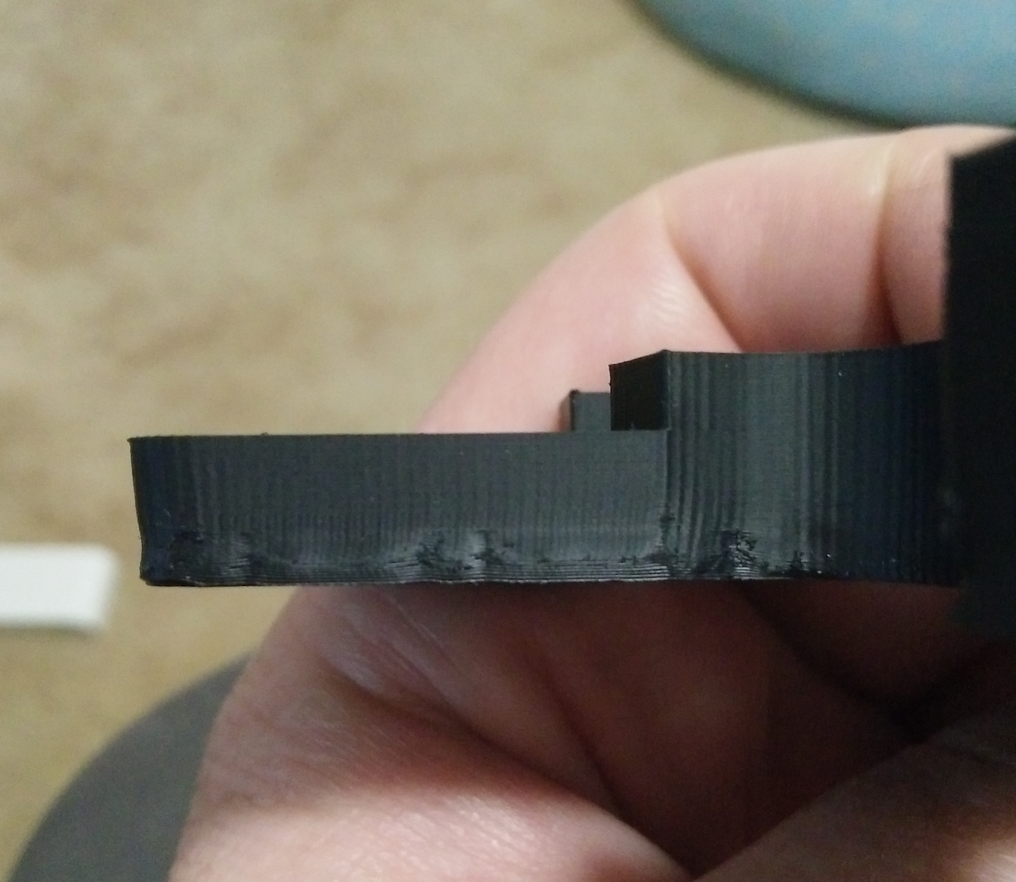

The other issue, or probably the same - see attached. The surfaces on the side of the model are being sucked in around the screw holes, or so it seems. It's a lot more noticeable on the S3D print, as well as the less then vertical walls. Could it be an infill setting? I'm using lines at 30%. 5 bottom layers and 6 top layers. With Cura it seems a lot less severe. My other printer (prusa i3 mk3) and sliced in Slic3r, same filament and the surface is close to perfect. It's a strange one for me.... can't seem to work it out.

can you post the STL or is it propitiatory? What filament are you using?
Or if you have someplace to share the Factory File that would be better I guess as we can see your settings

Thanks again airscapes. The STL I can't share as it belongs to a company. The filament in these pics is eSun ABS+ and I have also tried Zortrax ABS with same results. The Zortrax ABS prints at a much higher temp of 270, the eSun at 240.
I printed the whole part last night using the Cura sliced gcode and it turned out very similar to the S3D print, possibly slightly better. So, slicing off a portion of the model to use as a test is not a fair comparison in this case.
I will take some print screen images of my S3D settings today and post. Hopefully somebody will see straight away what I'm doing wrong :oops:
