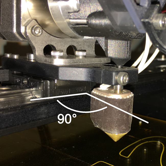

At any point did the hot end get turned or twisted in the clamp? If the heater block is not perpendicular to the x-axis rail, you will sometimes see uneven extrusion between one side of the calibration cube and the other. (One wall will be significantly thinner than the others.)

Not that I am aware of! I can't imagine it is loose...If it were moving around, wouldn't it mess up the prints even more?Jules wrote:At any point did the hot end get turned or twisted in the clamp? If the heater block is not perpendicular to the x-axis rail, you will sometimes see uneven extrusion between one side of the calibration cube and the other. (One wall will be significantly thinner than the others.)

No, not that it's loose, just that it turned. The heater block needs to be completely perpendicular to the rail before you tighten the clamp. (I'll update this with a picture in a minute.)
Like this:
Like this:

I never really understood that theory... If the barrel is round, the nozzle is round(ish) and the block is machined correctly it really shouldn't matter which direction it's mounted. but hey if it fixes the problem...
Re: Extrusion calibration
I didn't either, but I've experienced it, and sure enough, turning the block back around fixed it. No idea why it happens.sthone wrote:I never really understood that theory... If the barrel is round, the nozzle is round(ish) and the block is machined correctly it really shouldn't matter which direction it's mounted. but hey if it fixes the problem...

Hmmm . my RevE came from Makergear with the hot end rotated 90 degrees to that - the leads coming out of the right side. Haven't touched it.Jules wrote:I didn't either, but I've experienced it, and sure enough, turning the block back around fixed it. No idea why it happens.sthone wrote:I never really understood that theory... If the barrel is round, the nozzle is round(ish) and the block is machined correctly it really shouldn't matter which direction it's mounted. but hey if it fixes the problem...
Not something to worry about really, unless absolute dimensional accuracy is necessary for your print, or you see a problem.zemlin wrote: Hmmm . my RevE came from Makergear with the hot end rotated 90 degrees to that - the leads coming out of the right side. Haven't touched it.
(And it might not be the same thing for the Rev. E machines...they're a different animal, and untested so far for this particular issue.)
