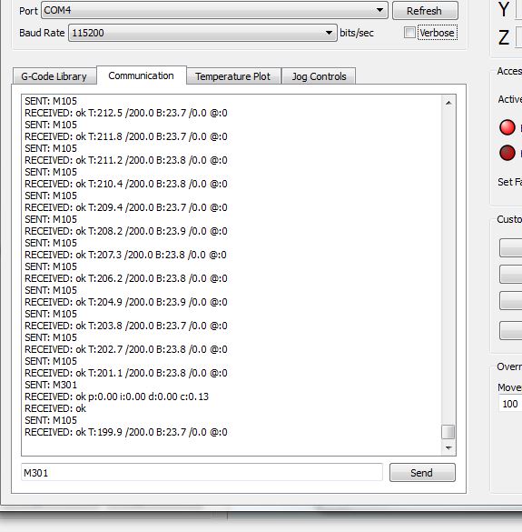

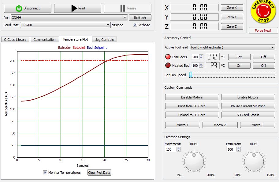

Even with P0.1 I0.0 D0.0 I get 15C of overshoot. This seems crazy. I've just been using M301 to set the values. I've also been using M500 to save them to the EEPROM. They echo back fine, so I believe it is taking them. Further, as I have tried various I and D values (ranging from I=0.1 to i=3 and D=6 to D=425) the response after the initial overshoot is very different.
I've done some runs with P set as high as 48 and can get the overshoot to increase as high as 24C.
To confirm my suspicion, I just did a run with P, I, and D all set to zero and the hot end still heated up with a 13C overshoot. i attached some screenshots of this behavior.
It is acting like there is some minimum value for P below which it is ignoring my commands. Is this possible?
