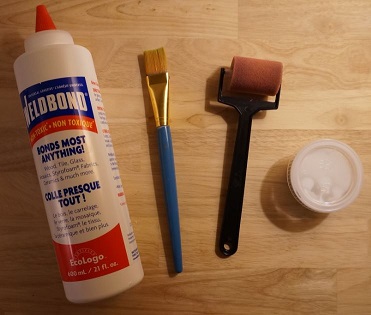

That's about the same proportions I use, maybe a little less concentrated like 1 part glue to 3 part water. I use a different brand of glue called Weldbond but I think it's probably the same as elmers.
I've only used it for PLA but I love it. I can vary the strength if I need to depending on what I'm printing. Each coating lasts for multiple prints- 5 at least and the last one was still working even after that but I cleaned it anyway.
I use two plates of glass and treat them both at the same time, then just swap them out from print to print. When one print finishes I take the glass out and let it cool on a wire rack, put in the other plate, do the level and z-height through S3D, and I'm good to go for the next print.
Lately I've tried mixing more solution than I need and storing it diluted. I use a brush to put it on the glass, wait a minute or two, then go over it with a roller to make it smooth and even. Here's my toolkit:
