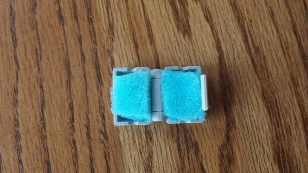

From Toby:
There is evidence to suggest that dust can accumulate on unused filament and eventually make its way into the nozzle during printing. This can cause the filament to extrude in a distorted way and mar the print, or in extreme cases, lead to clogging and no extrusion at all.
Fortunately this problem can be solved by a simple DIY technique of placing a dust trap physically around the filament before it enters the tube on the way to the nozzle. Here is a picture of one such setup:
In this case the wrapping is made of a lint free wipe and secured with a cable tie This brand is Kimwipes and is available cheaply at Amazon here: http://www.amazon.com/gp/product/B0013H ... UTF8&psc=1
Others have reported success using a paper towel or a small piece of ethylene foam with a hole poked through it by the smallest Allen wrench that comes with the M2.
It's also important to keep your filament dry. PLA in particular has a tendency to absorb moisture from the air, which can cause problems during printing. (Note: What problems exactly? Also, do other filaments have the same problem?)
Below is a picture of one simple setup for storing filament and keeping it dry:

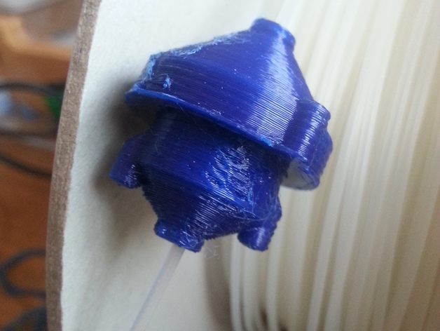

Keeping Filament Clean and Dry
From Toby:
Found this as a slightly fancier filament dust remover you can print yourself http://www.thingiverse.com/thing:302235/#files
filament dust cleaner.jpg (98.18 KiB) Viewed 98688 times

I made that other dust cover but you need to remember to put it on before you feed the filament.
I like this one much better.
http://www.thingiverse.com/thing:190118
