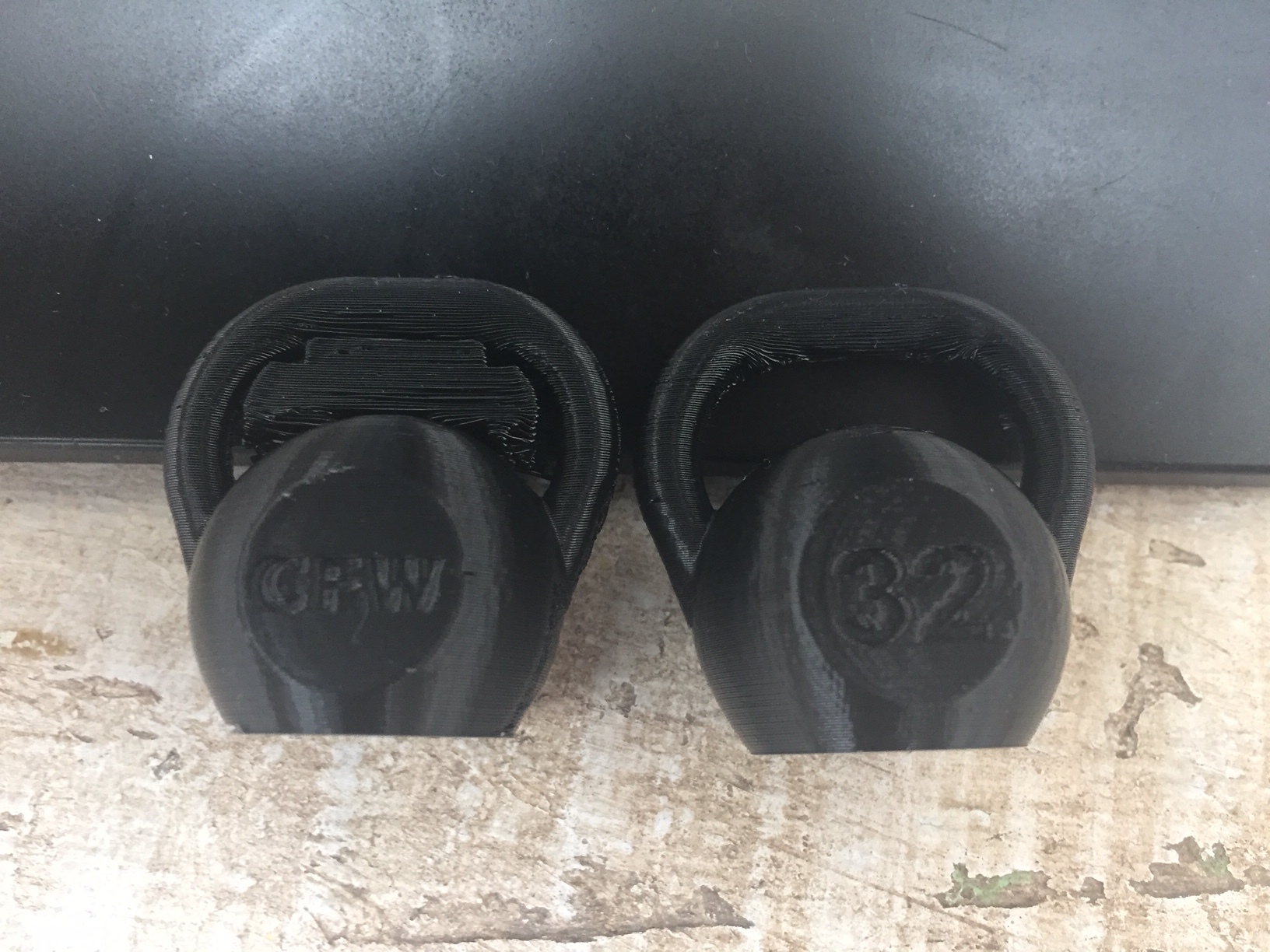

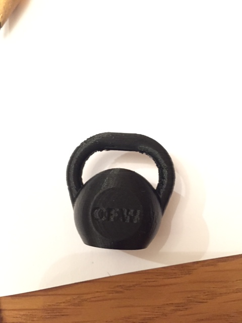

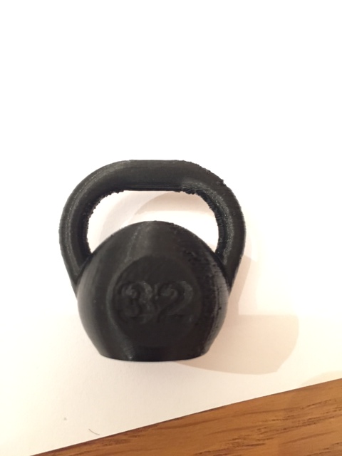

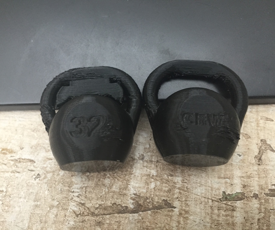

I am trying to print a kettle bell in black PLA. I have a strange issue with the model as it shows in the pictures attached.
Basically that is the same part with the same FFF but rotated 180deg. So the problems seems to stay in the exact place with respect to the printer position(it didn't rotate with the part)
Do you have any ideas why this could be? ( my thoughts were uneven bed, although I level it every other day)
I have attached the parts, FFFs and pics.

The defect is on the back part of the print, when looking at the front of the printer, right ? It is common with PLA and happens because the front cooling fan which is there to 'set' the PLA after it is extruded doesn't have quite as good airflow onto the back of the model as it does the front. I'm not really sure on best ways to fix it though, I'm sure other will be of more help.
A fan shroud that redirects the air all around the extuder is probably best, but I don't think there are any models out there to match the V3B (It's been on my TODO list to try modeling one up)
Printing slower would probably help too.
Also, make sure that front fan actually *is* running - I know it can be finnicky where if its set to run at 50% it can't actually start (it typically needs 100% power to get spinning, and can be ramped back afterwards)

Thanks guys!!! I completely forgot about the second fan addition. I will work to get one done and see how it goes.
Will try the part in ABS so that should rule out second fan I suppose.
Will post some ABS results soon I hope.

Yes, that's the front of the part and than the same rotated 180 deg. It seems to be the furthest away from the fan so I will try another fan placed on the bed and see hot it behaves - seems to be the easy option

So ... the 2nd fan option fixes everything! Big thank you guys!
Still some work to be done on the handle but it looks promising.
