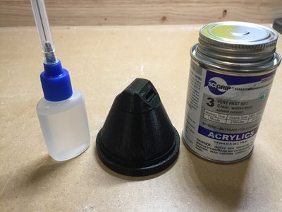

I have been experimenting with the perfect way to bond PLA and have found a flawless solution. Superglue CA leaves a terrible white halo, and is not a perfect bond nor gluing method. Epoxy is messy and adds material.
I use an acrylic solvent to weld the two parts together perfectly and without discoloration or additional materials added. It basically melts the PLA to join it to the next part.
You can apply through a applicator bottle with hypodermic needle.
You can either hold or clamp two parts together and squeeze some along the seam (be careful it is water thin and comes out quickly) or you can apply a bit to one surface and put them together.
they bond instantly., there is no discoloration and no adhesive build up.
You can also use the solvent to smooth surfaces if you experiment and learn its flow and effects.
links to products us bought below.
amazon.com/SCIGRIP-10799-Acrylic-Solvent-Water-thin/dp/B00466V8F0?ie=UTF8&psc=1&redirect=true&ref_=oh_aui_detailpage_o04_s00
amazon.com/Applicator-Bottle-Stainless-Steel-Needle/dp/B00BNI6TOE?ie=UTF8&psc=1&redirect=true&ref_=oh_aui_detailpage_o05_s00
