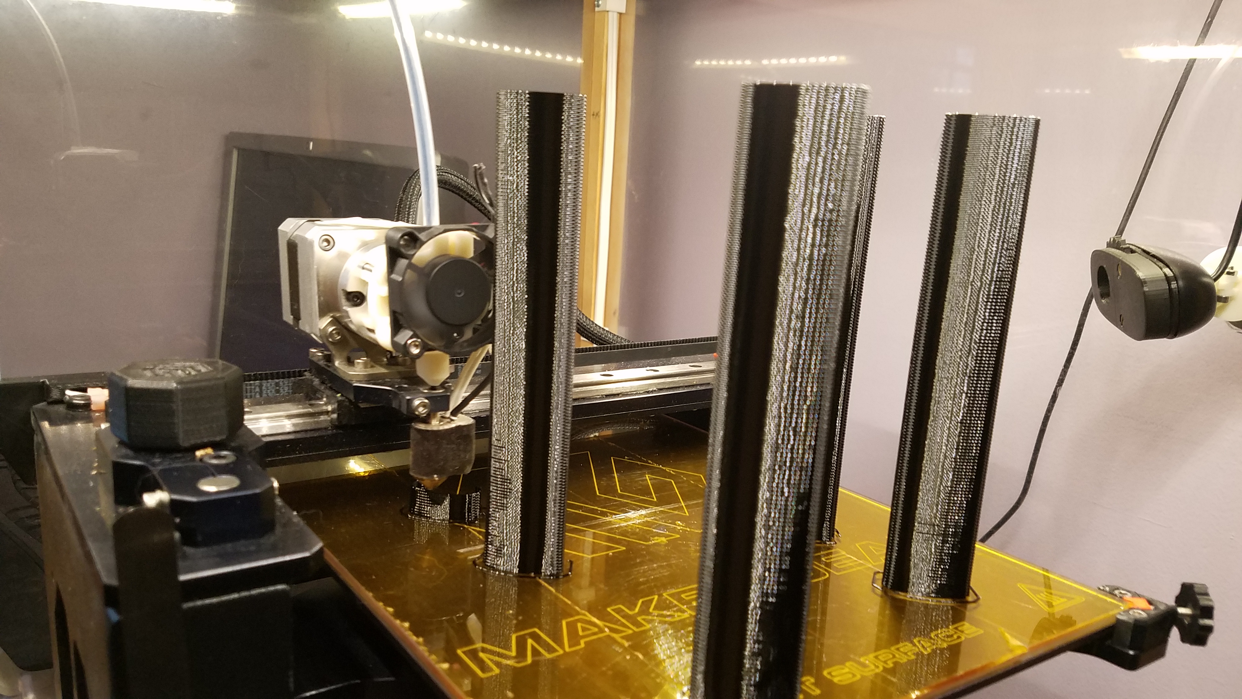

Setting your Z offset correctly with a calibration square with each and every layer height change.. i.e a .15 layer height requires a different offset than .3mm layer .. A 70 degree bed vrs 110 degree bed will require a different z offset. Just so you can see what is very possible these parts are printed sequentially using a .75mm nozzle and eSun PETG at 14mmS . They are on .8mm wall thickness, that is all that is on the bed .8 wide on wall.
