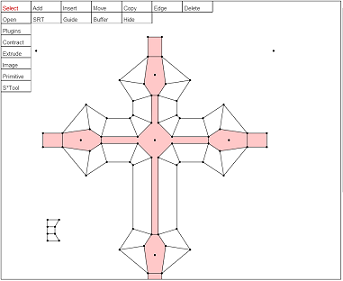

I don't know if you guys might be interested in "TobyCad". It's designed to be something like what you're talking about- a basic tool for drawing in 2d and making 3d objects, with the ability to plugin arbitrary code to do whatever you want. It's so minimalistic (and a bit quirky) that I thought no one using blender, openscad, etc would be interested, but if you're frustrated with those tools you might have a use for it.
It's written in javascript to run locally in the browser. So no compiling, OS, or server issues to worry about. If you can write C-code then you can add plugins and load them from your disk. Since it's just a web page, it runs in any browser that supports HTML5. I only use it in Chrome on my laptop so it's probably tuned to that environment, but if others try it I think any compatibility issues would quickly be found and fixed.
I wanted to keep it simple. My first commandment was, "Thou shalt have no cascading menus." The second was, "Thou shalt use no IDE." I edit the code in Notepad++. Here's a screen shot of a recent project:

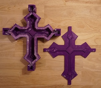

These are the 2D shapes I needed to generate the parts for a mold I was building. Here's a pic of the assembled mold that came out of it:
(Sorry for the religious symbols. I needed a test case that had 3d detail on every side and I like medieval looking things. The white stuff in the picture is the plaster that stuck to the PLA after casting.)
