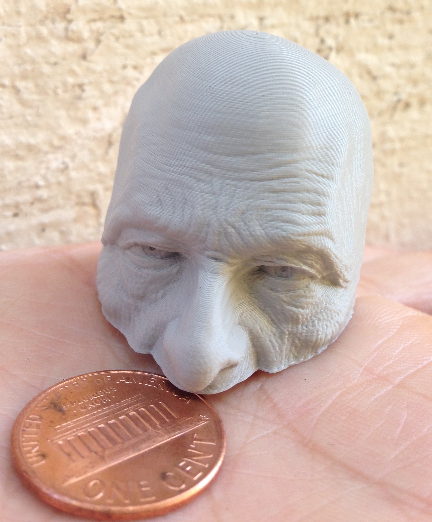

Here is an example of what I'm getting on the [UNNAMED PRINTER] at 100 microns. If I can consistently get something along these lines of quality on the M2 but with less ringing I would be a happy camper. Unfortunately the Dremel doesn't have any way to adjust Jerk and Acceleration settings in the firmware, so to reduce ringing you have to slow down the entire outer perimeter speed.

Those ripples on the cheek, is that in the model or is that excessive ringing?
Re: Show me your sub-100 micron prints!
Yes, it is ringing as I mentioned in the post. Some of it is the actual wrinkles in the old man zbrush sculpture too. I will post a screengrab of the 3d model tomorrow. The ringing is one of the of the downsides of my other [brand must remain unnamed due to forum rules**] printer. Hoping the M2 will alleviate that.
