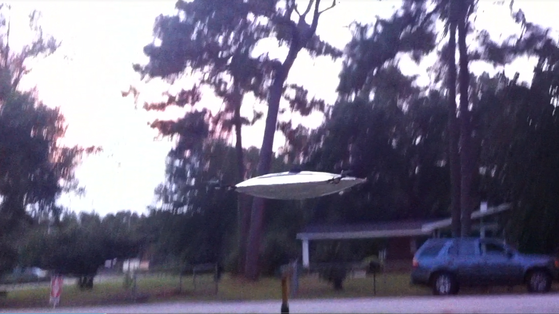

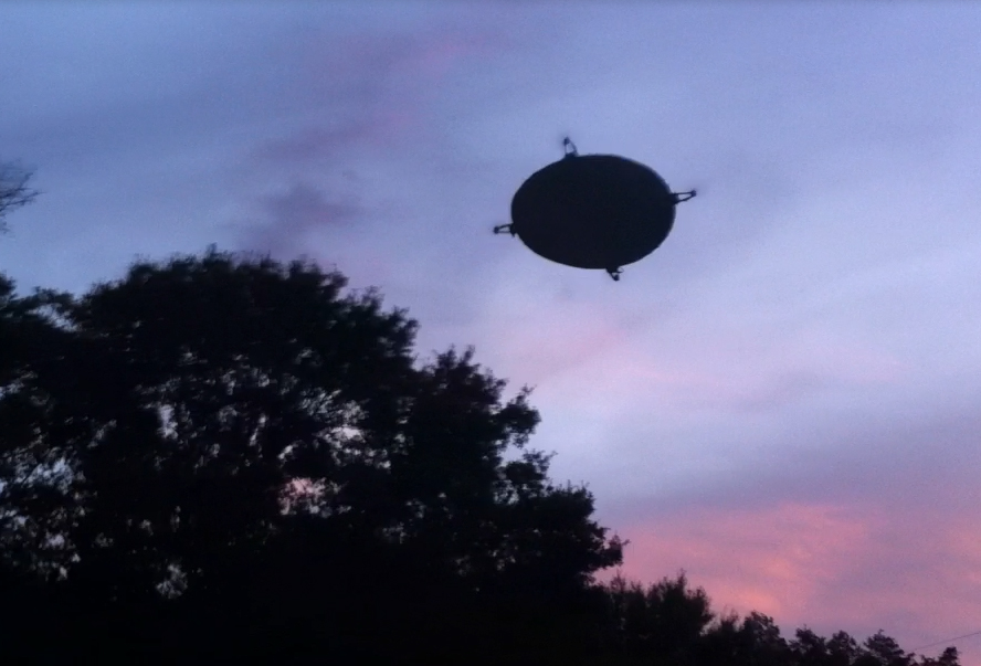

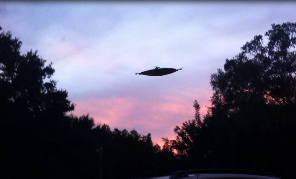

Post by pyronaught » Tue Jul 14, 2015 6:19 am
Some recent sightings

Post by lem » Tue Jul 14, 2015 5:39 pm
Yeah, I like that middle picture. Very nice project.
