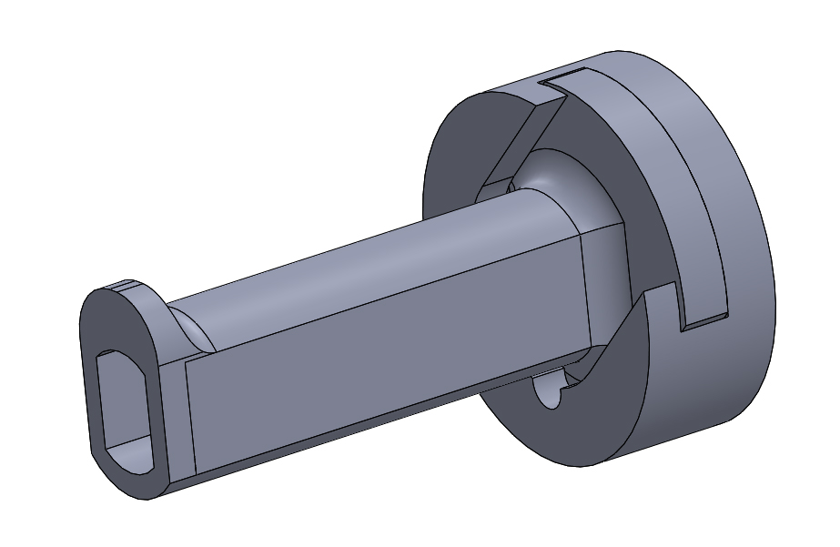

I'm working on compacting our M2 farm at work and came up with this detachable spool holder that lets you place printers closer to each other by removing the extra space that has to be allowed for sliding the spool on and off. This would also be useful if you were putting your printer in a box that wasn't wide enough to allow the spool to slide off in the normal way. The idea is that the spool arm detaches from the base so that you can slide a spool straight in from the front rather than from the side. A slotted base bolts onto the M2 frame using the same bolts and hole pattern as the stock spool holder, then the spool arm slides into this key slot at 45 degrees so it can never wiggle its way out from vibration. When you pull the spool up at 45 degrees, it pulls the arm out of the slot, then you change the spool and then put it back.
STL files attached if anyone wants one.

It's OK here. I like it -- I have that issue, two M2s are a bit snuggly on 4ft shelving.

For future travelers — I made a right hand version for the M3-ID. https://www.thingiverse.com/thing:4969024
Printing now to confirm fit. In particular this should make the printer easy to use with off-the-shelf enclosures like https://www.makergadgets.org/enclosures/p/innovator
