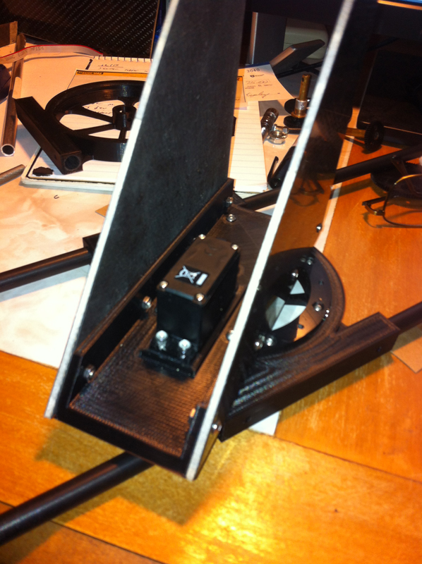

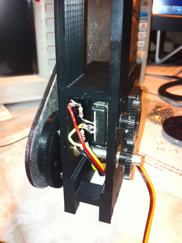

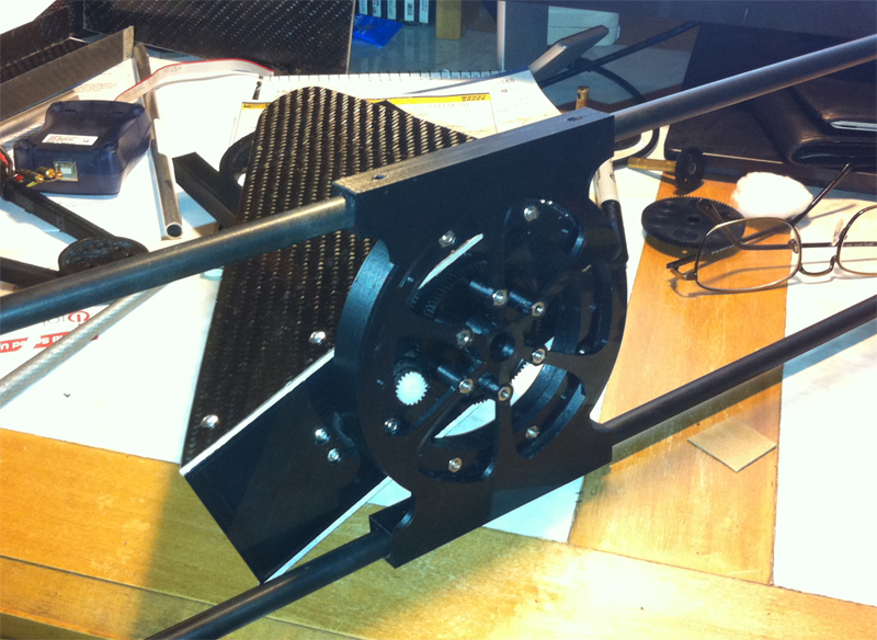

Just an update on the blimp project here. The motor mount swivel is done, complete with home-made balsa core carbon fiber composite bracket. The rest is all printed parts, except for the plastic gears and fiberglass rods. This same exact design would work pretty good as the rotating base for making a servo driven desktop robot arm.

Post by jimc » Fri Feb 27, 2015 3:46 am
Nice! How did you do the balsa core? Hand lay it, vacuum bag it?

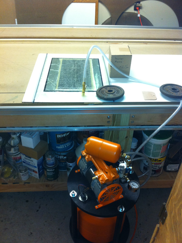

Post by pyronaught » Fri Feb 27, 2015 4:40 am
jimc wrote:Nice! How did you do the balsa core? Hand lay it, vacuum bag it?
Vacuum bagged it. That's what the pump project was for a few weeks back. It turned out pretty good for my first attempt, but I'm still trying to find the ideal release agent. Wax tends to repel the epoxy and leave gaps on the gloss side, while PVA leaves brush marks so that the finish isn't as glossy as the wax method. I'm going to try spraying PVA on next time. PVA on top of wax releases a lot easier compared with just PVA only, but then you get the same problem with the wax repelling the PVA just like it did the epoxy. I know the wax method can be made to work because I see guys using it on youtube, I just don't know how they are solving the problem of the epoxy beading up and leaving bald spots.

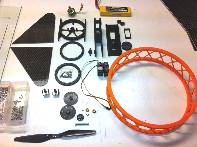

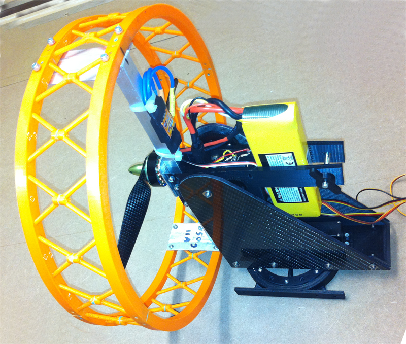

I got the whole motor pod done and working now. 19 hours total print time for 16 different pieces that are printed in three groups. The yaw axis has 180 degrees of motion while the pitch axis has about 120 since the back side of the mounting bracket won't allow it to go all the way around 180. Thrust from this on full throttle is 850g with a current draw of 11 amps, which was kind of surprising. I would expect higher current draw for that amount of thrust. Two of these on the blimp is really going to give it a lot of push.
