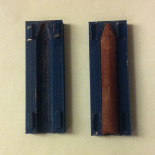

Look, I made a crayon.

Jin, could you explain what we're looking at there? Did you print a crayon mold and cast it in....what?

Crayon wax. Now I can make whole crayons out of partial crayons. Kind of silly.
