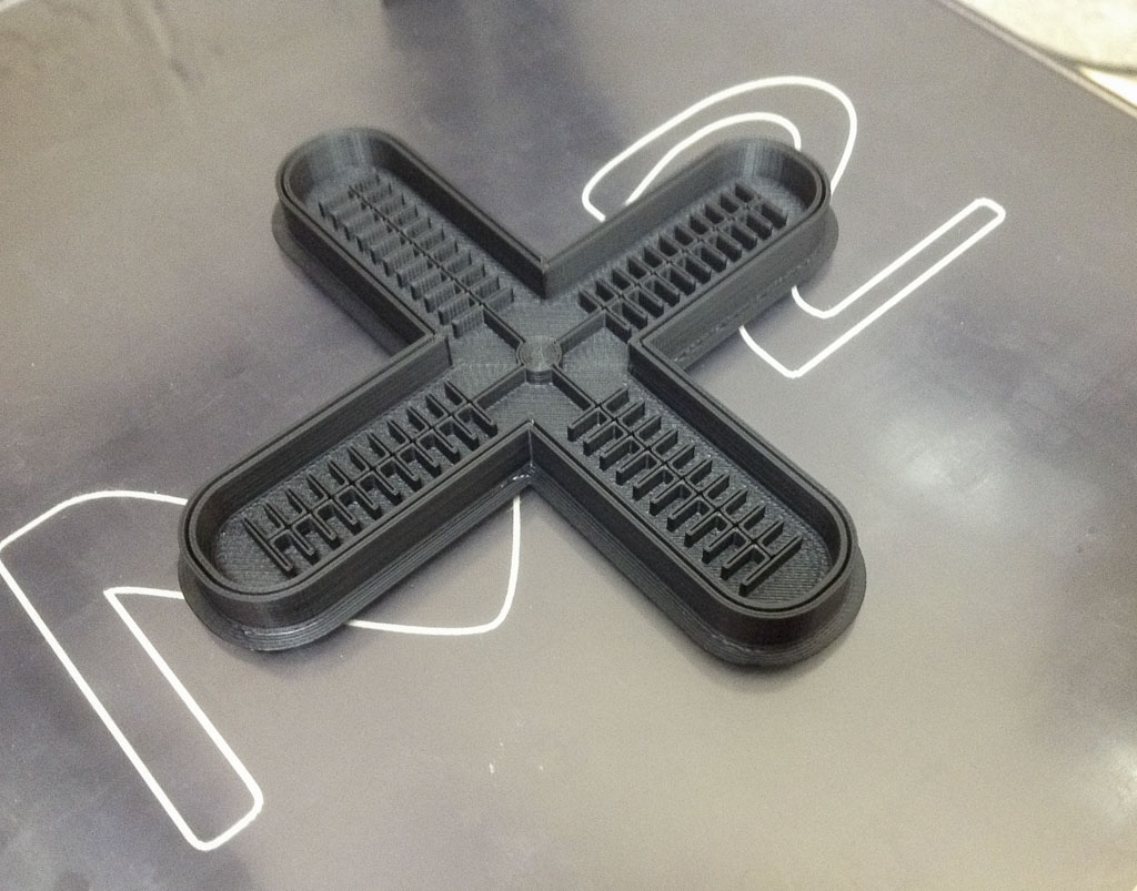

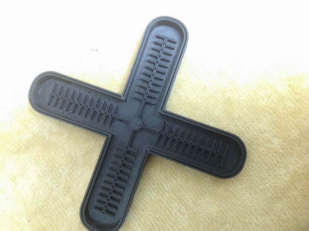

Made this for one of my first customers. He provided the link to the STL file. Came out pretty good!

Nice... but... if you're going to use it as a mold, you're going to want to fill in some of those internal gaps, which will trap whatever you're molding with and either make it hard to demold, or require finishing afterwards. Running a few quick tests, it looks like an extrusion width of .48 or .49 would do it, although I'm not sure how well it would work with a .35mm nozzle.
It looks the instructions call for a soft silicone, so it should work as is, but you may have a good deal of flashing to remove.

jsc wrote:Nice... but... if you're going to use it as a mold, you're going to want to fill in some of those internal gaps, which will trap whatever you're molding with and either make it hard to demold, or require finishing afterwards. Running a few quick tests, it looks like an extrusion width of .48 or .49 would do it, although I'm not sure how well it would work with a .35mm nozzle.
Wow! Thanks jsc for pointing that out. I've never done a mold before I didn't realize those gaps were not part of the design, but you are correct. Would I need to go to a .40 or .50 nozzle?

Post by jsc » Tue Oct 28, 2014 10:52 pm
I would just run a test print at .48mm and see what happens. You can set up a test print to just print off a few layers out of the middle to see how well the gap in the ribs closes with various extrusion widths: double click the model and move it by -z so that just the ribs are above the bed. And stop the print whenever you've seen enough to satisfy you.

Post by jdacal » Wed Oct 29, 2014 2:58 am
jsc wrote:I would just run a test print at .48mm and see what happens. You can set up a test print to just print off a few layers out of the middle to see how well the gap in the ribs closes with various extrusion widths: double click the model and move it by -z so that just the ribs are above the bed. And stop the print whenever you've seen enough to satisfy you.
I think that did the trick. I tried .48 and it closed up completely along the X axis but still had a very tiny slit on the Y axis lines. I turned it up to .52 and everything closed up nicely with no apparent overlaps. As the print progresses that might change but will post a picture when done.
Thanks jsc I didn't know that setting could make such a radical difference.
