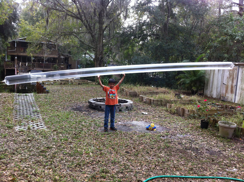

For a thin wall inflated tube, 5 psi might not seem like much pressure but it is significant. Consider the average inflatable has less than one half PSI and the Goodyear Blimps are inflated at .07 PSI. While you can't really see the 3D printed two-piece plugs holding the ends of the 24 ft long tube below, you can see that they hold up to the pressure without leaking and are designed to avoid any 90 degree sheer stress on the film. I spent almost two weeks printing all kinds of plug designs, blowing up tubes and shooting plugs across the room like a cannon when they failed--- but it would have taken MUCH longer to prototype this any other way. Doing it on a lathe would have taken more skill than I have due to the curves and matching tapers involved. This is my first use of a 3D printer to solve a problem and it really worked out great!

interesting. so what would someone do with a clear inflatable tube?

jimc wrote:interesting. so what would someone do with a clear inflatable tube?
The tubes are so rigid even with just a few PSI that they can be used as structural elements. They have been used as inflatable supports in temporary outdoor structures such as tents and shade covers, with the ability to quickly assemble and disassemble with minimal storage space. NASA is even using them for inflatable structures to be deployed in space due to how little space they take in storage and the high strength to weight ratio. I am experimenting with using them as structural elements sewn into the fabric of a new type of hot air blimp I am designing. It's a very ambitious and expensive project I've been working on for years now in the form of scale RC prototypes, so I'll need to get a roll of smaller diameter tubing next to use for the RC model. The one in the picture is the size that would be used for the full sized blimp. A development history of the RC model can be found here: http://www.rcgroups.com/forums/showthread.php?t=1405313
