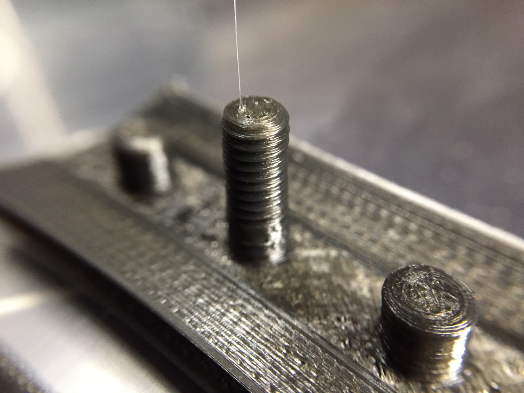

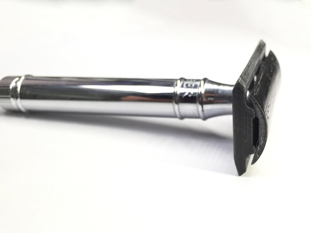

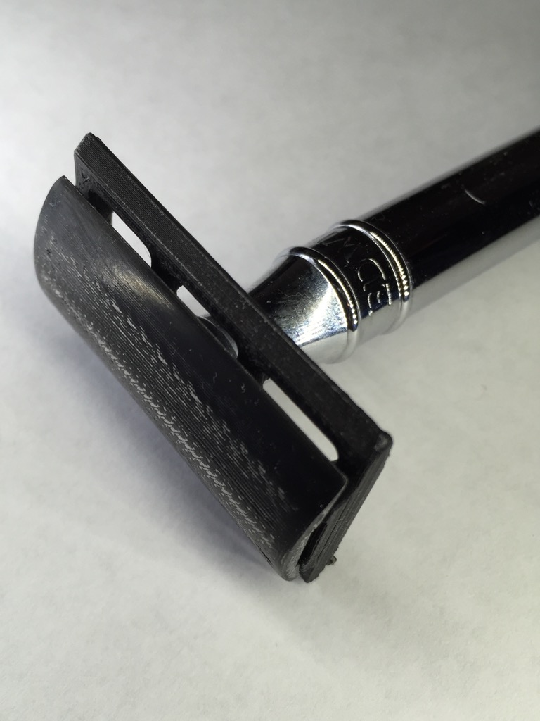

My friend Rob (rsilvers, of S3D profile settings and filament drive fame) has been using his microscope adapter to take close up photos of a safety razor and model it precisely. I printed it in PLA at 0.10mm layer height:
Check out that printed M5 thread:

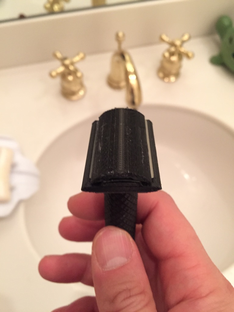

With handle and blade, ready for a test shave:

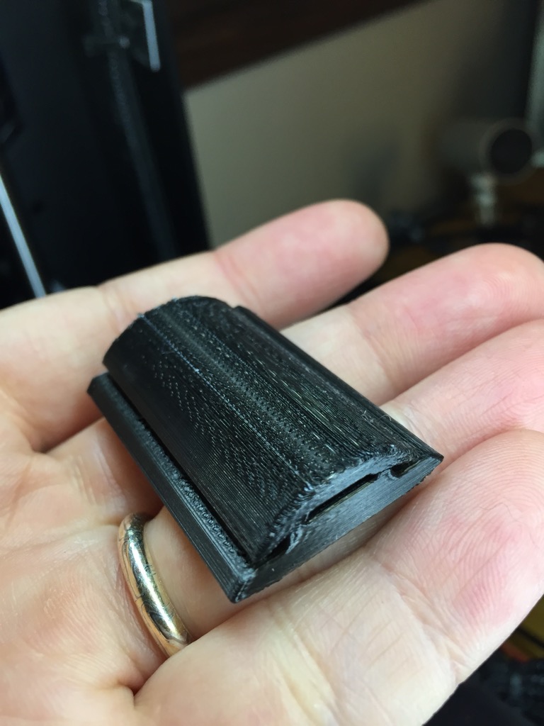

Some more playing around with finishing. Sanded, then brushed with IPA Weld-On #4. Smooth to the touch where the layers are more vertical, but as it rounds out it gets harder to smooth without pitting. Also, the sanding appears to have bleached out the PLA somehow.

Does anyone know why sanding would bleach the color? I thought the pigment was imbedded throughout the plastic.
Re: safety razor
Post by insta » Tue Feb 17, 2015 8:29 pm
jsc wrote:Does anyone know why sanding would bleach the color? I thought the pigment was imbedded throughout the plastic.
You're creating little air pockets when you sand. The air pockets scatter the light before the pigment can do its job. Sand with a finer sandpaper and re-smooth with IPS #4.
Re: safety razor
Post by jsc » Tue Feb 17, 2015 8:45 pm
I went from 220 to 1000, that's not enough? I grew tired of sanding. Maybe I will try epoxy.
Re: safety razor
Post by insta » Tue Feb 17, 2015 8:46 pm
1000 should be plenty. Epoxy or IPS #4 should do the trick then. Maybe just try smoothing it again?
