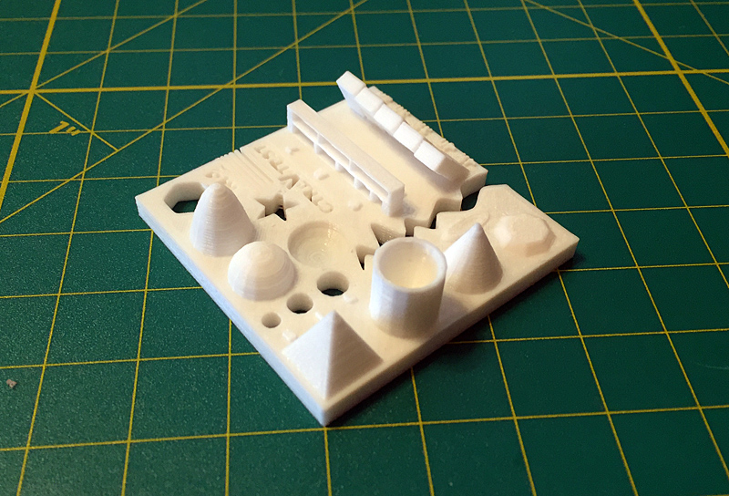

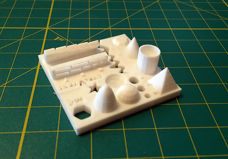

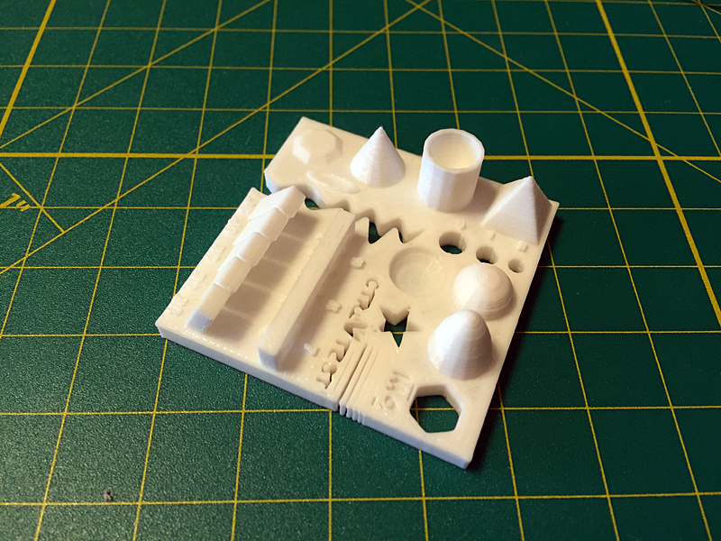

ok, so none the less... here's mine.
Re: Anyone try this new calibration piece?
Post by Jules » Fri Mar 06, 2015 11:41 pm
Wow! :geek:
