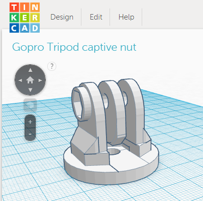

Simple GoPro tripod mount. 1/4-20 nut pressed into base
http://www.thingiverse.com/thing:277027

Could I offer a critique? Having the nut nest in from the bottom may tempt the whole thing to pull out (even if its glued). Perhaps have a slot cut above the bottom disk so that the nut cant pull out.
http://www.thingiverse.com/thing:713400
Unfortunately my remix of it would need support...
That's the same issue I had back in the day with the penny bottle openers that were popular on thingiverse for awhile. Like those, you could mitigate the problem by just decreasing the nut's hole size a bit more, and then heat the nut up on the stove hot enough so it'll melt into the ABS/PLA/whatever you used, and then weld it into the model that way. Requires playing with fire, but I think we could handle that :)

My original idea was to combine this thing with the Quick connect arca Swiss mount. I tried to combine them in 123d but when I printed it S3d saw 2 pieces and tried to print them sideways with 2 brims. What a mess. This one turned out with the nut recess distorted so I used an arbor press to press in the nut.
