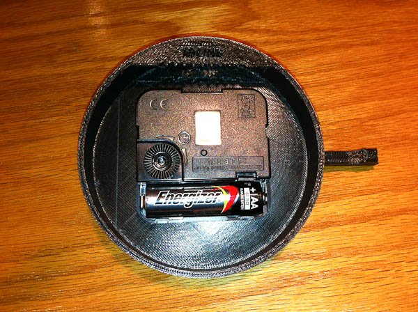

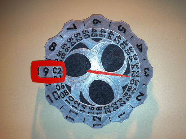

I can't claim credit for the concept, I saw this Clock on Reddit the other day and I was inspired to try and design my own. It's a pretty unique concept, you read the time off the little window to the left.

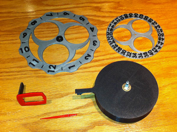

The five basic parts.
It runs off a normal (high torque) clock movement.

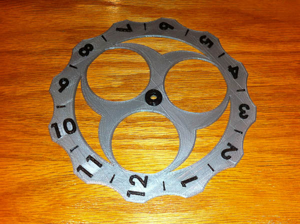

The hour Dial... The print was paused when it got to the numbers layer and the filament changed to get the black numbers. This was the first time I tried this in S3D, turns out it's pretty easy to do.

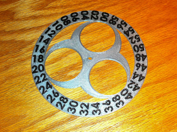

The minutes dial.

That turned out great! Love the color change effect too - I generally only pause S3D when my print is cratering - glad to know it can be used for something useful as well! :D
