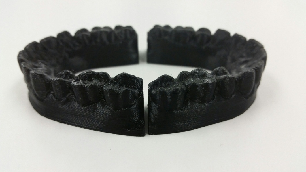

Sorry for cell phone quality and mediocre lighting...
100 micron on the left vs 50 micron on the right.
I did not optimize settings for the 50 micron print, I just used the 100 micron settings since I was lazy and wanted to see what the M2 could do. It could probably use a little bit more retract to help with the little bit of stringing in the crevices of the tooth crowns.
My friend owns an Objet Dental 3d printer and he wanted me to print some samples for him to compare his 25-30 micron prints.
