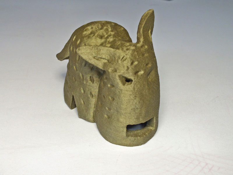

Post by jimc » Mon Mar 23, 2015 3:45 pm

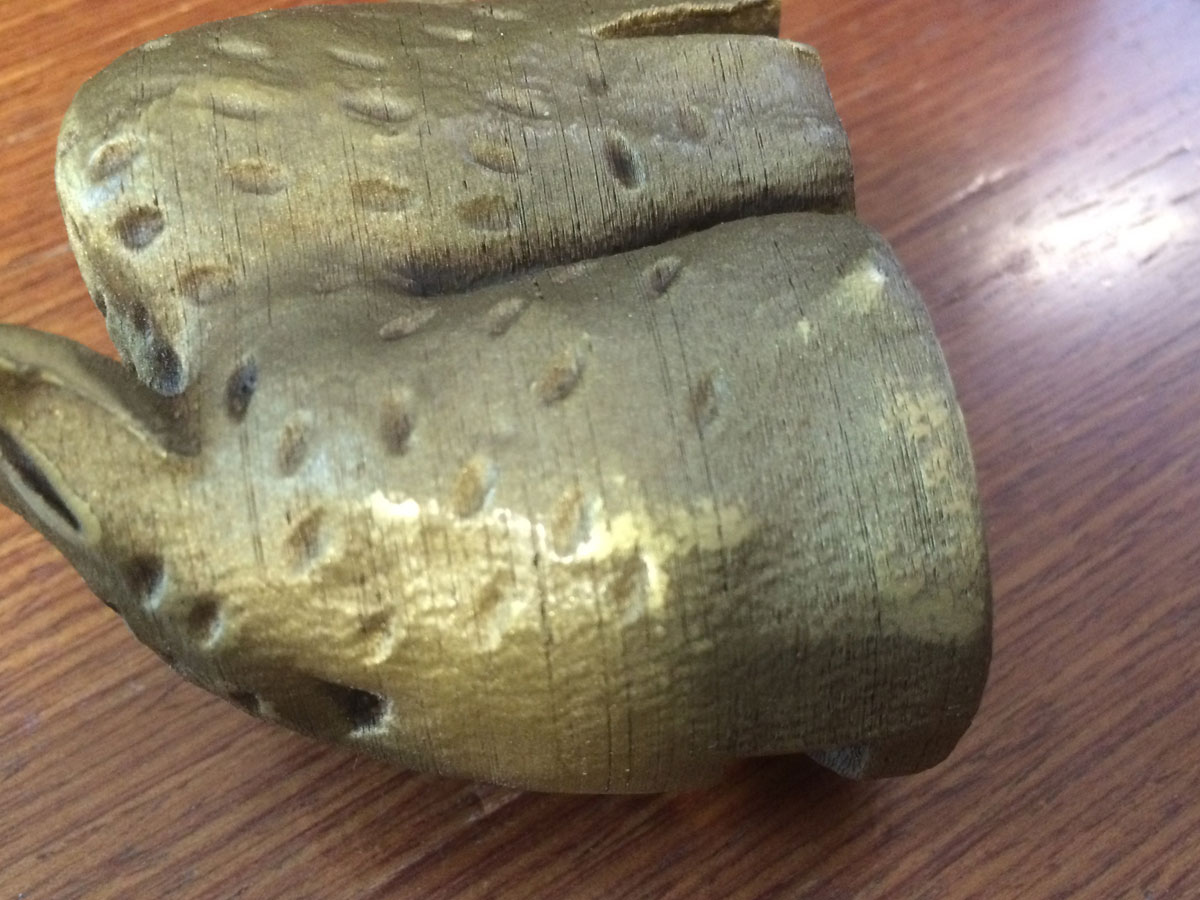

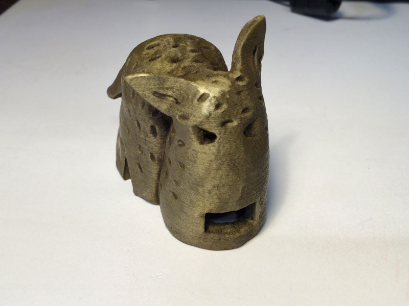

i did a print of walter's ollie character posted on thingiverse. will at intservo gave me a sample of the esun bronze filament a while back that i never had a chance to try out so i figured this would be good for that. he gave me just enough since i woke up this morning with only 6" of filament still in the ptfe feed tube. the lighter color print is right off the printer. the second darker pic i gave it an aged bronze appearance just by wiping some dark brown glaze on it.

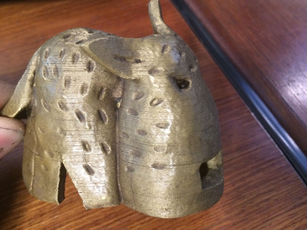

you can see the areas i buffed. it smoothed out the layer lines on the high spots making it smooth and shiny.
