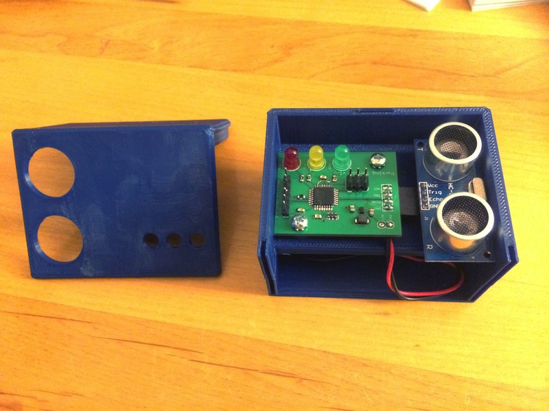

Here's an enclosure for a parking aid sensor I've been working on for a little while:
Very simple case with stand offs, a battery compartment, and some slots/tabs to stay together:
https://github.com/jinschoi/parking/blo ... e/case.stl
https://github.com/jinschoi/parking/blo ... re/lid.stl
Here's a video of it at work: https://www.youtube.com/watch?v=eTVb-AUKWIc
Designing 3D printed enclosures around electronics, rather than the other way around, is just so much more civilized.
I got some sagging on the bridge, I think maybe I'm printing bridges TOO slow now, and slightly faster might be cooler. Has anyone nailed down their bridge settings yet?
Also, my slot/tab closure, while it works, isn't super secure, and a little bit fragile. Suggestions on mechanical fasteners for box-like objects?

DesignSpark Mechanical. I could have done it in OpenSCAD, except that getting chamfers and rounds is currently a bit of a pain. Also, I began the process by roughing out the two boards and the connector, using both measurements from the PCB design file and from calipers, then using that to design the enclosure around. It was conducive to using a visual CAD program.
The rsdoc file is in the github, but I am in the process of reworking it to make it slightly nicer. For one thing, it was my first design in Imperial units (because PCBs are laid out in inches), and it made me uncomfortable; I'm more familiar with metric units. So I'm redoing the whole thing as metric, and moving the grooves around a bit, etc.
If you don't use DesignSpark Mechanical, or even if you do, I'm not sure this design would be useful to you directly. It is easy enough to recreate it in whatever program you use. I wanted to have a mechanical latch, but the two long mortise and tenons seem secure enough for now. The bridged shelf is hard to print cleanly, for some reason I always get a few saggy strands at the forward end; I'm trying it with manual support just for that portion now.

I think countersunk screws is a fine idea, but I wanted the enclosure to be openable without a screwdriver. The boards themselves mount using the standard #4 screw, but I sized the standoff holes to self tap, which works fine.
I started by roughing out the dimensions of the board+connector+sensor as a few rectangular cubes, with any parts that stuck out more than usual (like the transducers) added. Working around a however crude representation of the board makes things a lot easier.

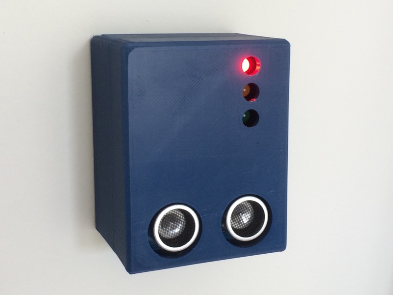

by jsc
More enclosure action for a revised version of my parking sensor. I wanted a more positive closure action, and mechanical snaps seemed fiddly and would take more experimentation than I wanted to invest. I had a bunch of small neodymium magnets sitting around though, so I put in posts to hold them in the box with matching ones on the lid, and they worked great. The lid snaps into place and is held securely.
If anyone has done any designs using mechanical snaps, though, I'd love to know of any guidelines you've learned.
