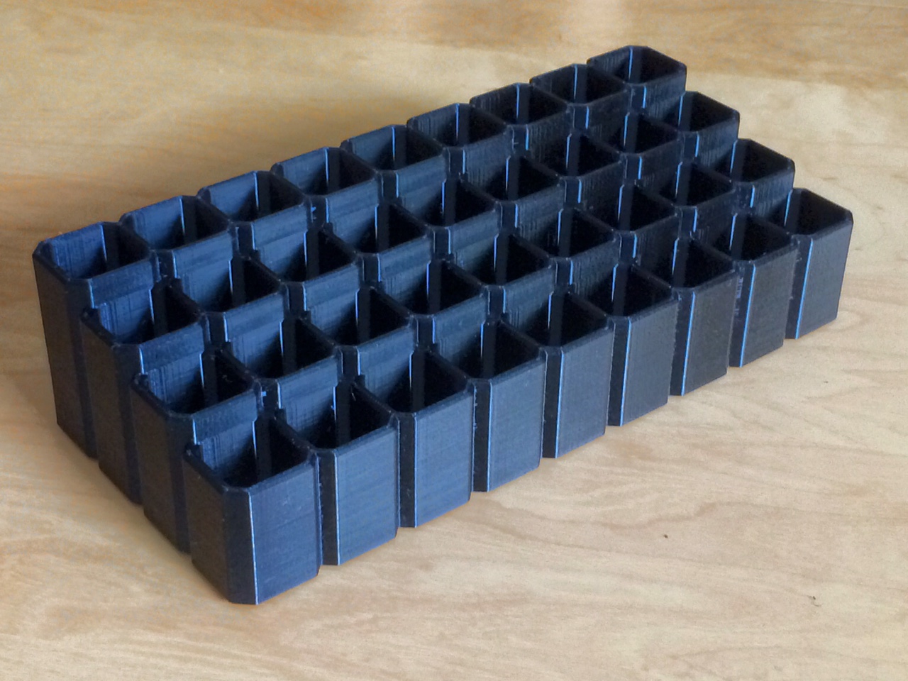

She has an 18-cell rack and asked me if I could double that capacity for her.
I pushed the Y axis of the M2 to the limit with barely enough room to fit in a 1-outline brim.
This is eSun PETG. I used the .35 nozzle and .2mm layers. I run slow on solid infills and outline so my build times run long. This was a 42 hour build. Ran it on Kapton over glass. The edges of the print lifted the Kapton film just a little.
