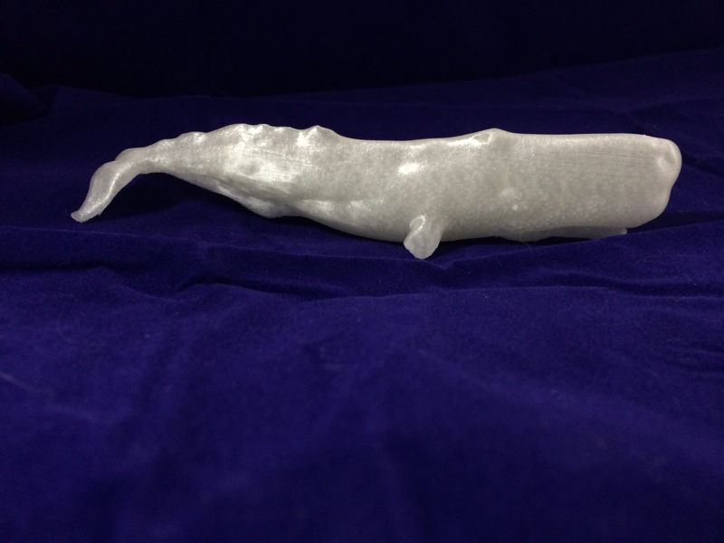

My daughter is studying whales at school, so I decided to print her one to take to class: http://www.thingiverse.com/thing:182337
Natural PLA at 0.10mm, double model scale.
With previous versions of Simplify3D, I had random infill turned off as it would tend to disturb the seam placement and make it look messy. That would have turned the visible interior of the whale into a checkerboard honeycomb. With the latest version, you can place the layer start explicitly, so I turned that back on which gives the visible infill a mottled, almost organic texture. I was going to coat it in primer, but I think it looks fine as is.

Really? I think it (natural PLA) looks awful! This is the only print I've ever done in natural PLA that has come out remotely good looking. Also it photographs terribly, and tends to make things look like they were made out of bird's nest soup.

Awesome print! So you changed the exterior seams to start somewhere in a less conspicuous place? I'm trying to figure out how that changed the infill look. Can you clarify?
Re: Thar she blows
The reason I didn't like to use random infill is because it had the side effect of moving the layer start point around, even if you had randomize layer start turned off. With the new setting, that is no longer an issue so I turned randomize infill back on and that has the pleasant effect of making natural PLA look less than awful.

What layer height did you use, and how did you generate support?
Re: Thar she blows
.10 mm, Simplify3D automatic supports extended by 1 mm.

Tim, in the new version you have a setting to take your selected supports and inflate them a bit to cover that in between gap that can get missed from the end of one support to the start of the next one.
