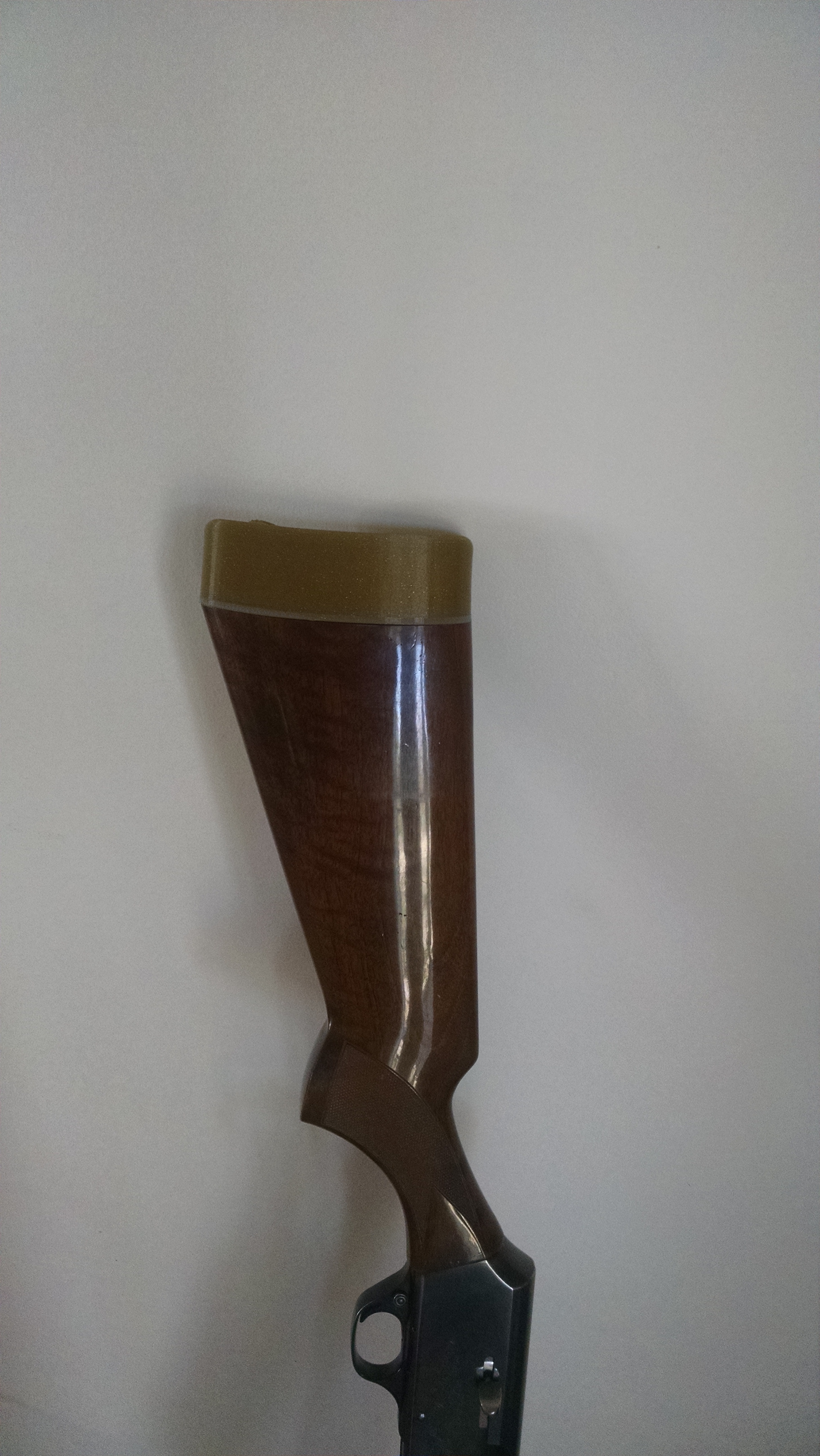

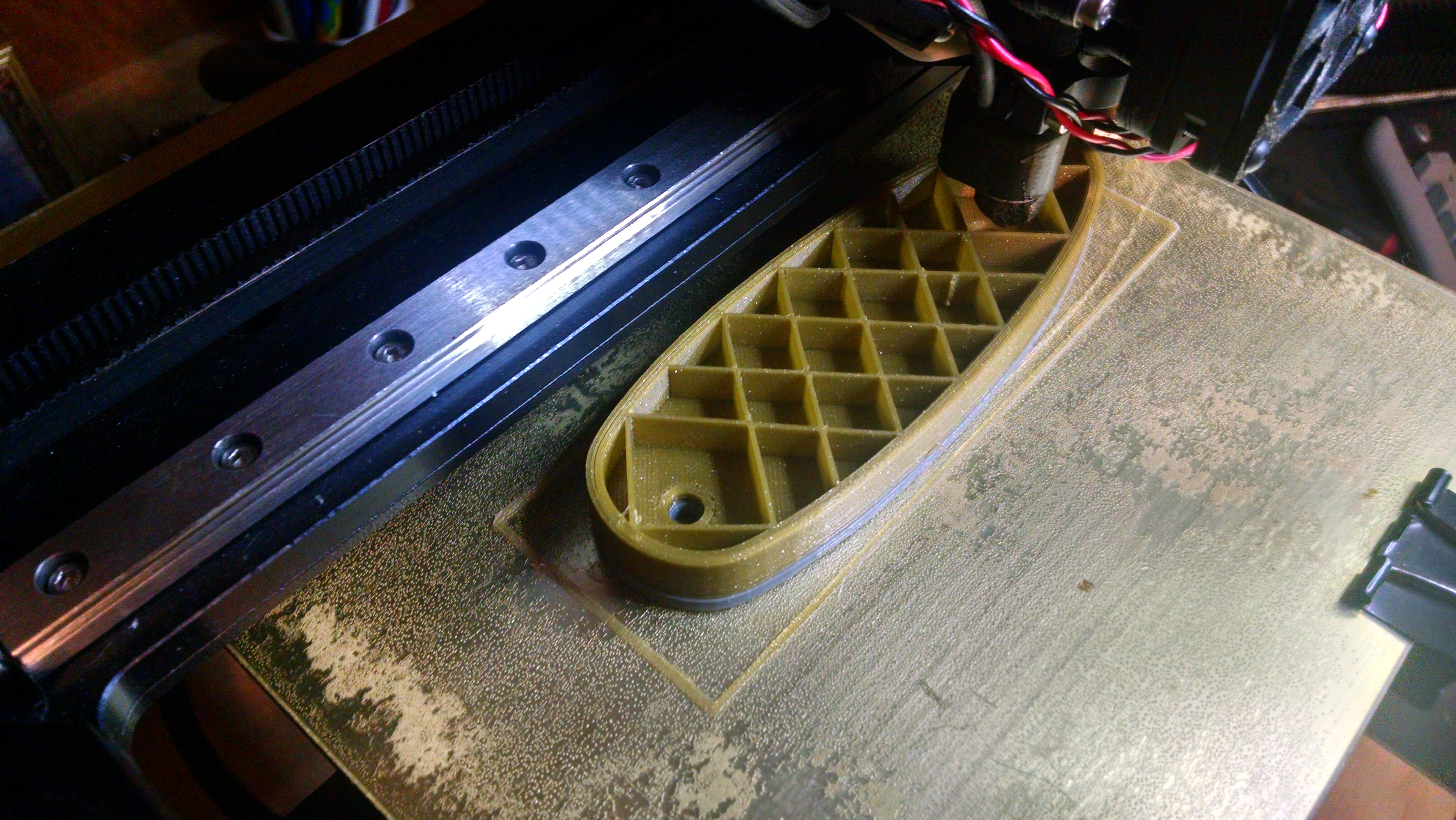

I finally had a successful print using PETG for the base and Ninjaflex for the flexible pad. The pad printed really well, at a very slow pace. S3D gave me an initial time of 1008 minutes, but as always it took much longer. I used very thin internal structures to provide the cushioning. I made slots in the top of the pad to get the screws in; one slot printed perfectly, but the other was slightly rough. All in all, in seems very functional, and I will test it by shooting soon.
