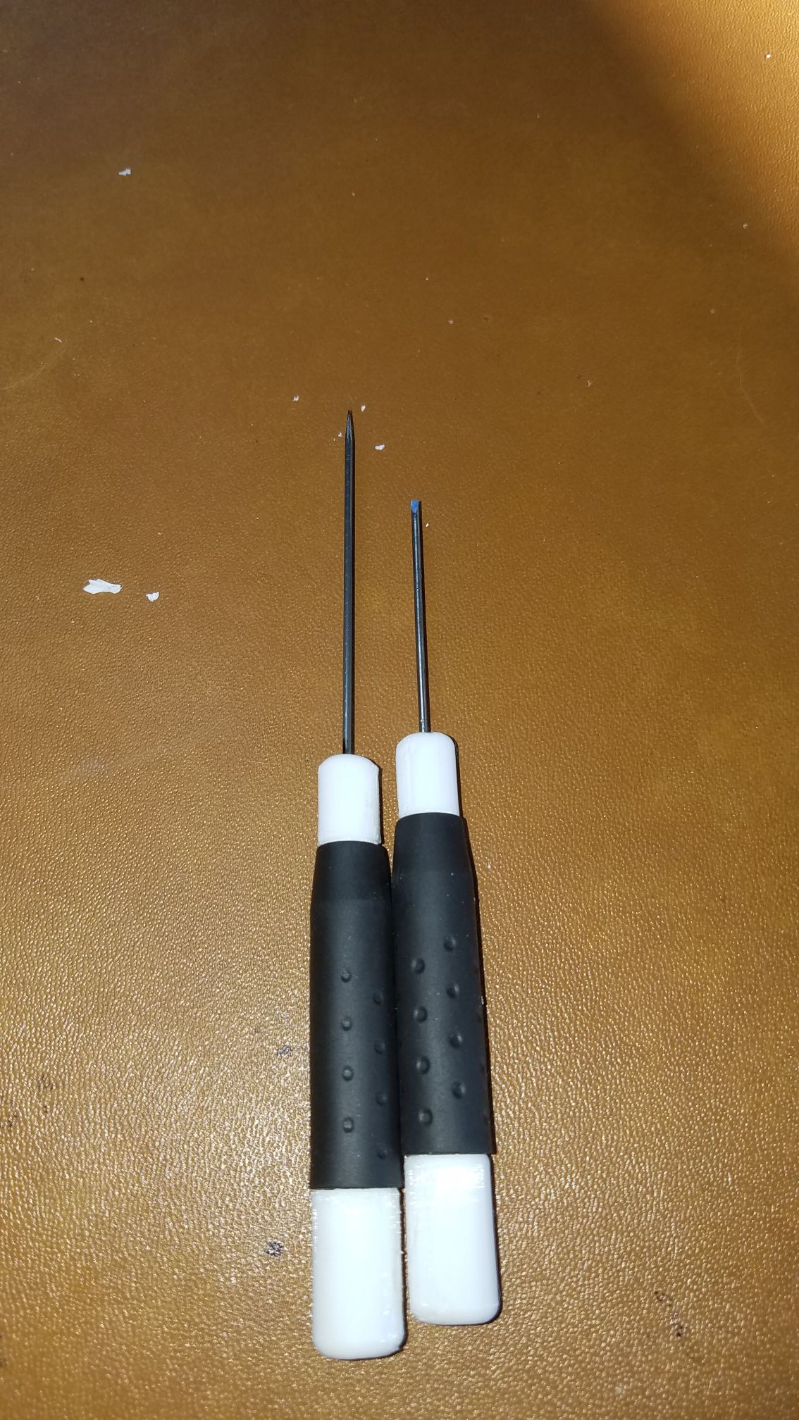

I have a some dental picks I use when weeding supports from miniatures and wanted to make my own tools.. So I picked up some 3/64th steal wire lenghts at a hobby shop and made a holder out of PETG that the rubber sleeve off of a paper mate pen would fit for added control.
Wire is cut to length put in a drill press and pushed into the 1mm hole that is 25mm deep while spinning at slow speed. Once it is press into the hand the tool end can be worked. I sliced this with S3D using 3 process to print the area behind the back of the pin at 100% infill but it really would probably be better to do the entire thing at 100%. When slicing I raised it off the bed and use 25% 1mm supports form the bed only, 2 solid layers and 2 dense layers (Simplified 3D )
This model is in the public area at Onshape.com if you should want to alter it to accept a different sized wire
Pin Holder 1mm hole.stl
(1.36 MiB) Downloaded 2352 times

Pretty cool idea of using the rubber sleeve off the pen.

That was the Wife's doing.. Hey, do you have any use for these rubber things off these dead pens??? 3 days later I did!
