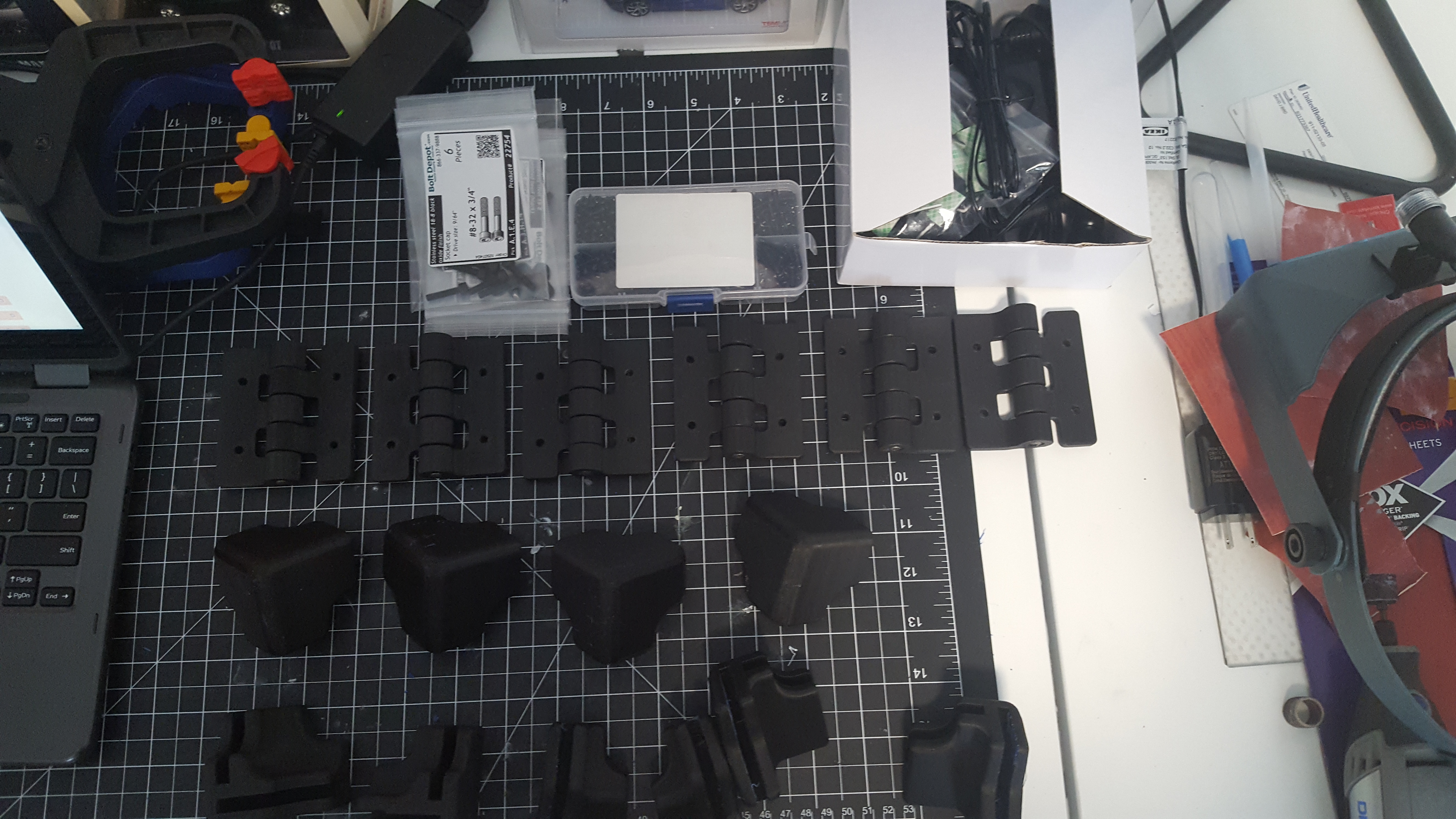

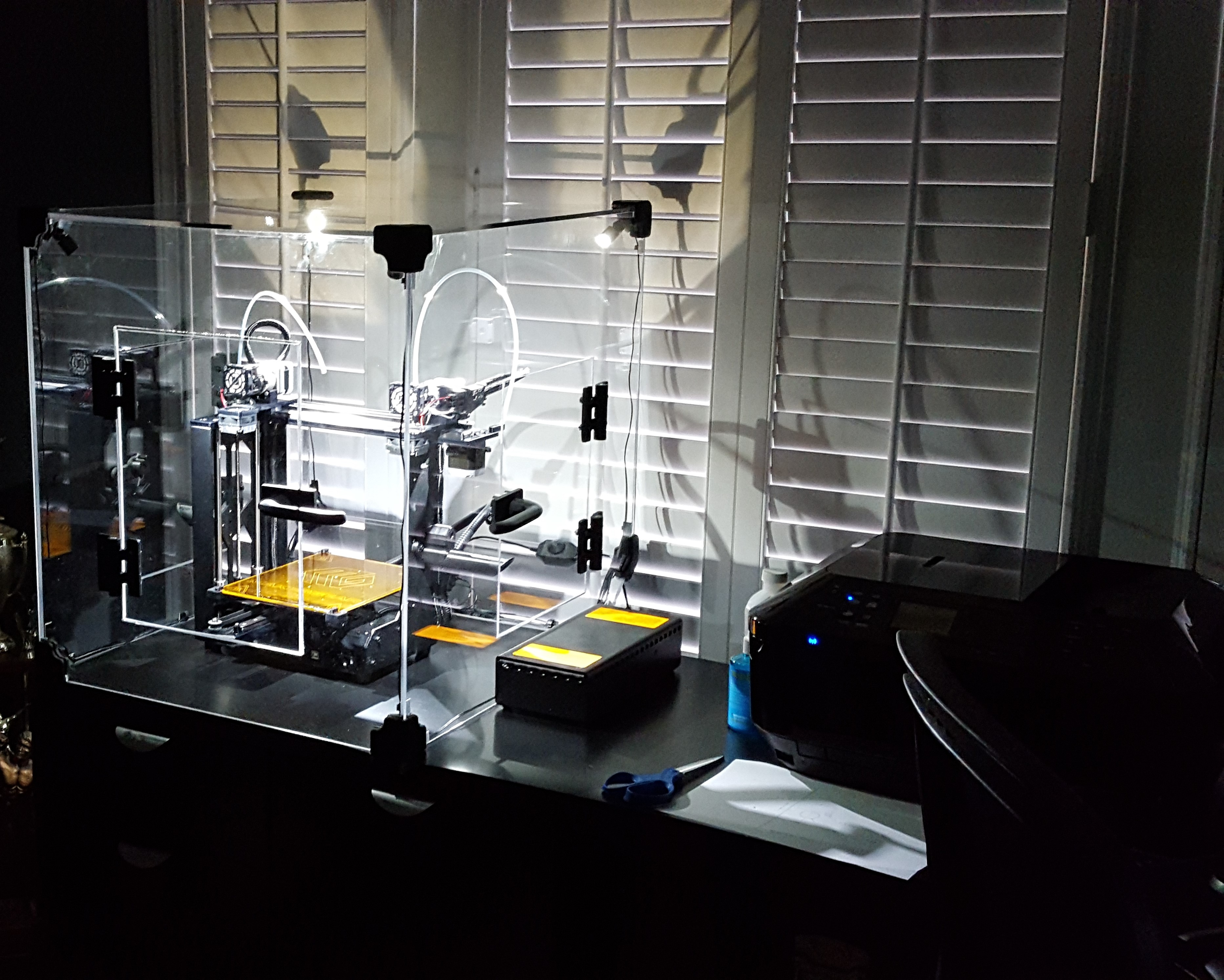

I was having difficulty getting consistent results while printing with ABS so I decided to build an enclosure. My first thought was to make something quick and get on with it. Then I began to envision the possibilities,I decided to make a project out of it and do it right. I ended up with something I'm happy with and it is quite functional.
It has 3 doors that enable changing and loading spools. I've even swapped out hot ends through the doors with the enclosure in place, I was also able to level the bed with it in place. It has lights that can be actuated remotely via smart switch. It has a video camera and heater as well as an internal thermometer and humidity sensor. I set it all up on stand with ample storage for filament as well as tools.
Enjoy the pics.

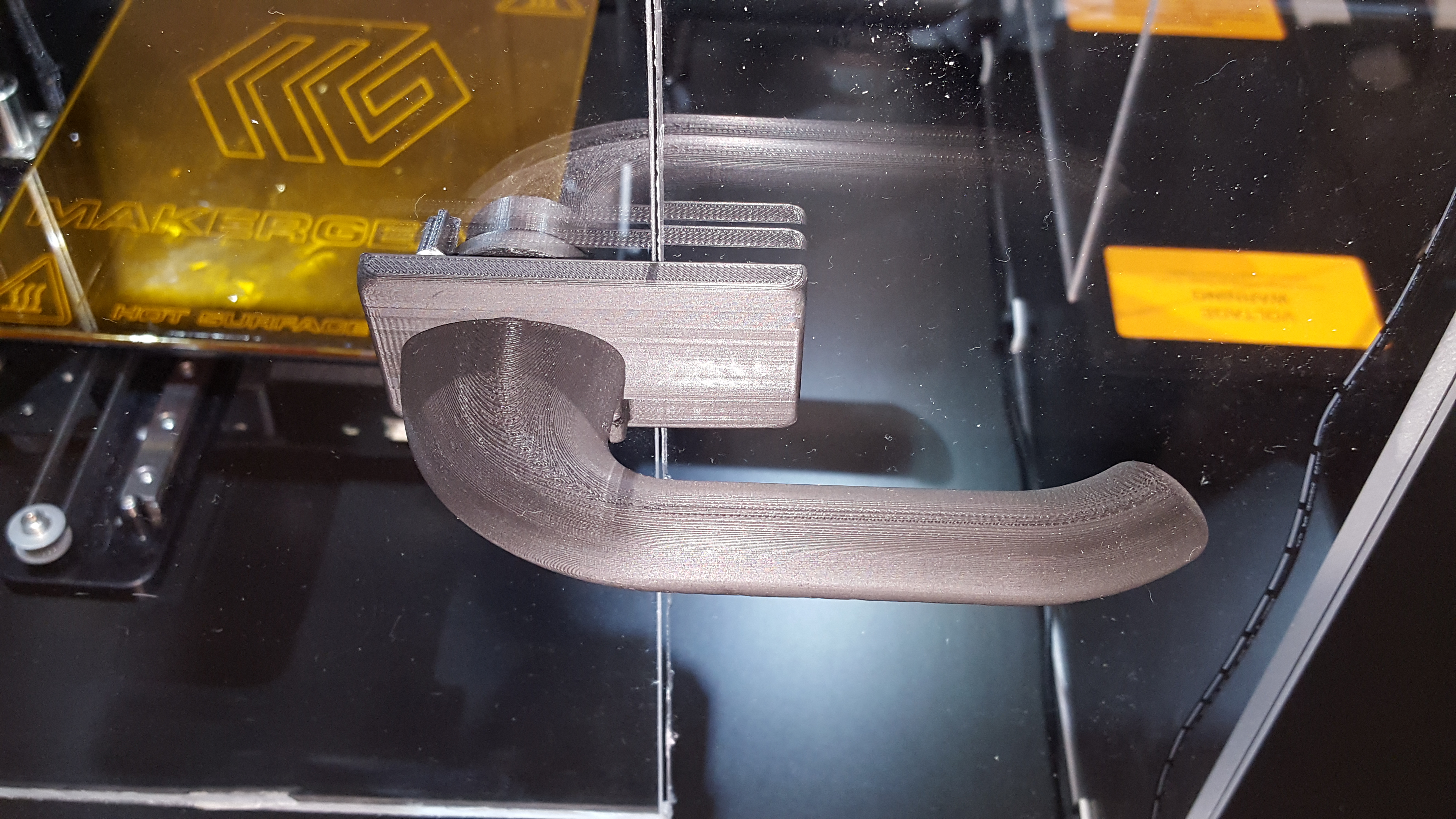

Door Handle
Lit up at night

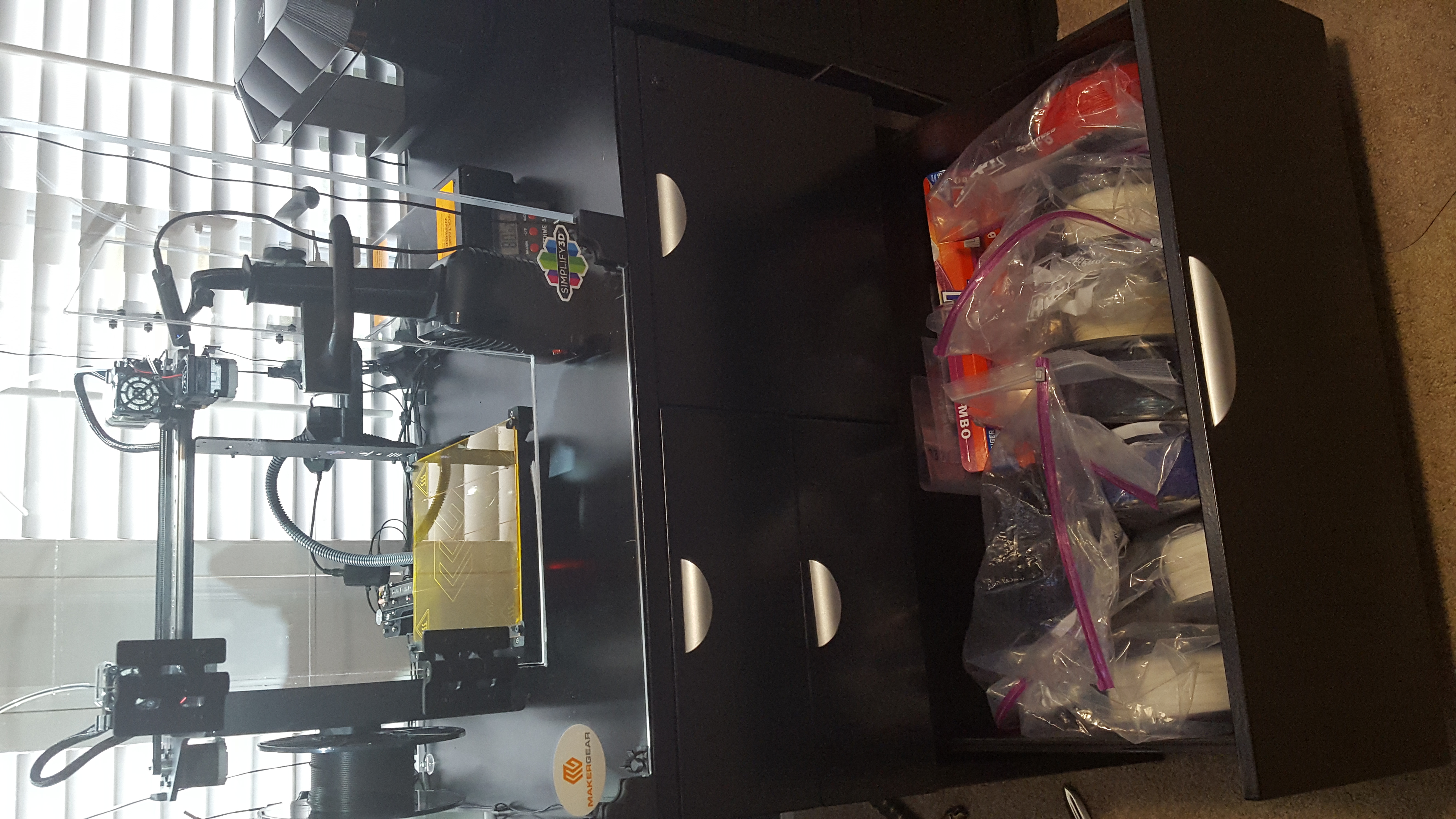

Storage

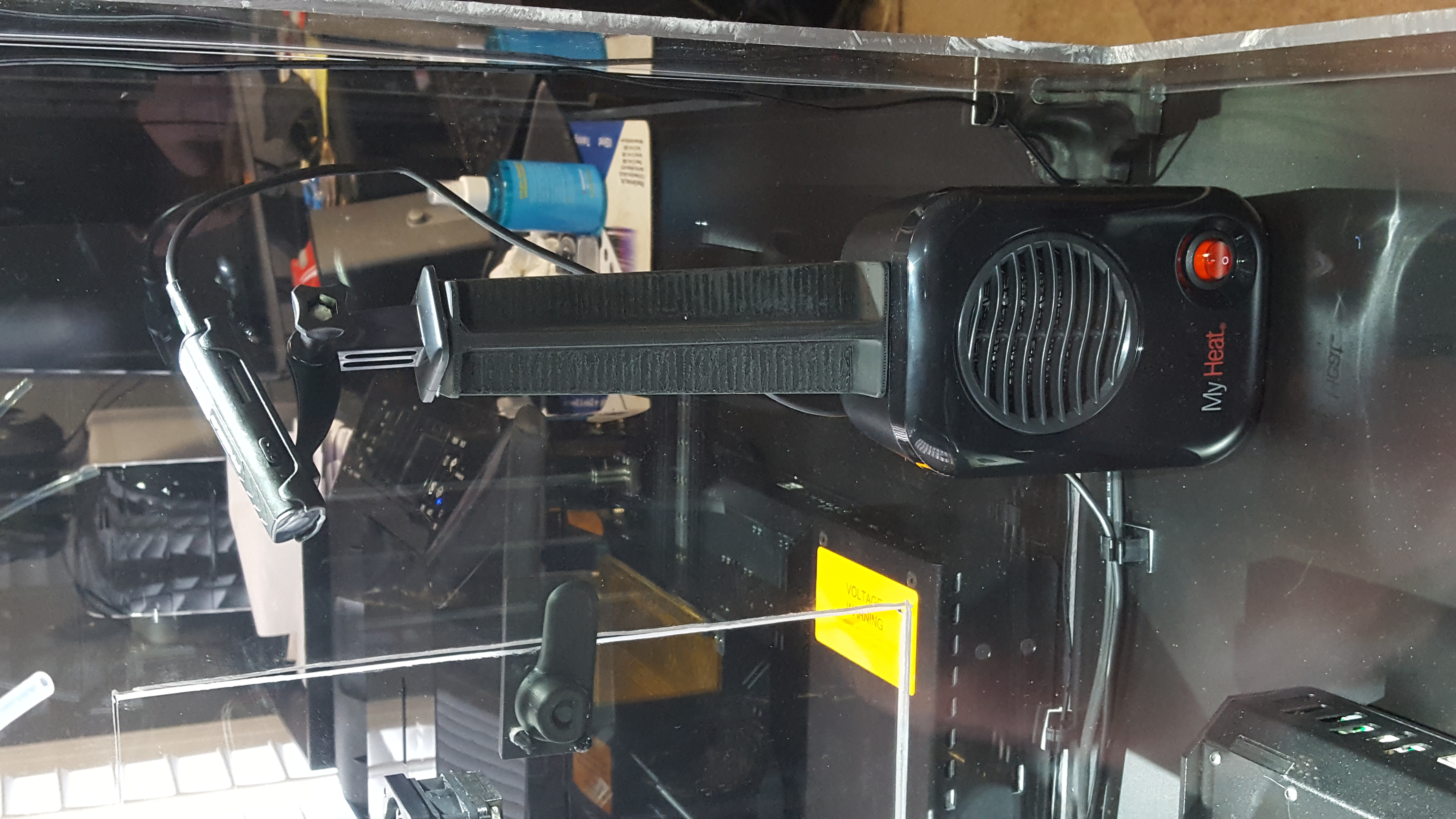

Camera atop printed pedestal on the heater
The printed hardware

Does your heater have a thermostat? You mentioned a thermometer? What temperature have you found to be best for printing ABS?

Hello John,
Thank you for your interest and the compliment.
No, the heater does not have a thermostat. It's just a cost effective personal space heater, it was only $14.99. The thermometer and humidity sensor was also cost effective, it is meant for reptile terrariums. it was $19.95 on Amazon. I am still experimenting with temperature. With the heater off and just the heat emitting from the printer the average temp inside the enclosure is around 85 F. With the heater on I have seen temps as high as 110 F. I suspect the optimal to be some where in between. With large prints I have started with the heater on and then switched it off once the temp is around 100 F. It will stay around high 80's low 90's with good a result. For smaller prints I usually will leave the heater off. However, I have found the heater very useful for speeding up the bed heating process which can be be quite long otherwise.

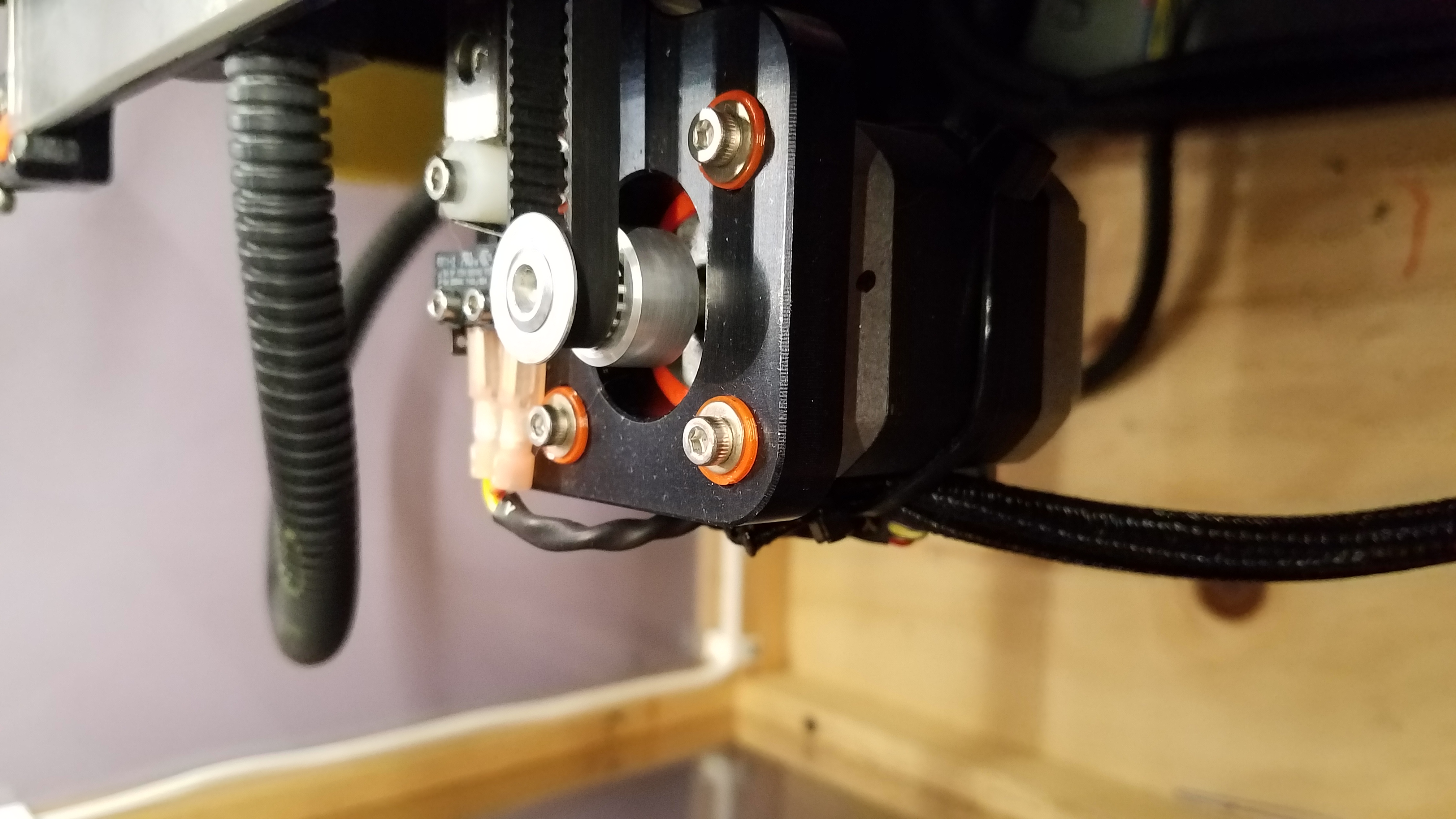

For the noise I printed dampers our of ninjaflex and placed them between the X an Y stepper and ninjaflex washers for under the screws.
I have attached the files if you wish to try them. You will probably need to replace the screws with the next longest size.
You will not believe how much quieter the machine is. Unlike the dampers you can buy on ebay that only use 2 screws, these use all 4 so the motor does not twist. You will need to adjust the height of the pully on the steppers to compensate for the 2mm damper.
Print everything solid..
