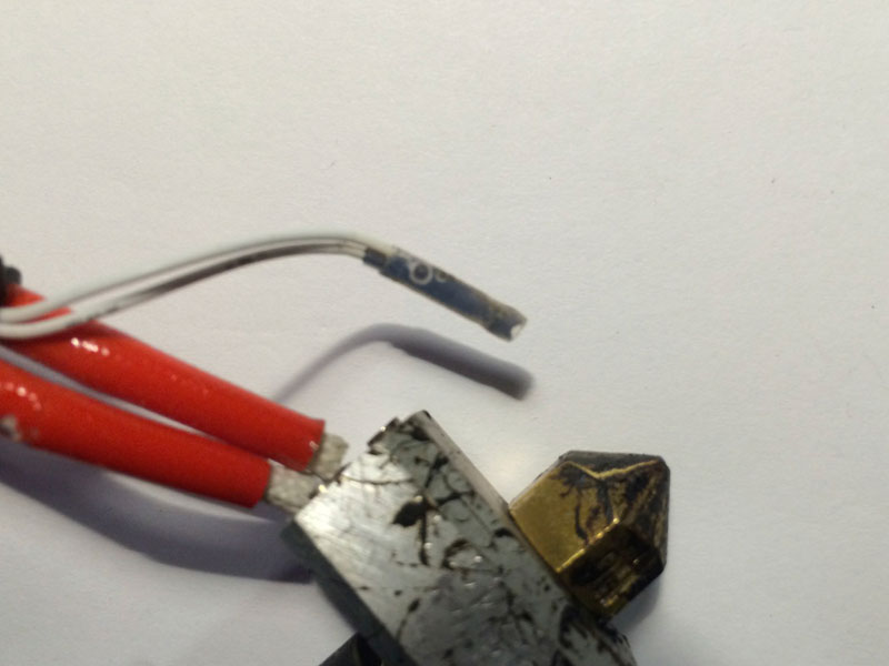

Okay found a disconnected wire coming from the terminal block associated with the 2 fans connected in series. Had to replace both fans. Thank goodness there is a Fry's within spitting distance. Now the only problem is the thermistor has come loose from inside the heater block and loses contact as the extruder heats up and shuts everything down... ugh.
RTV? Glue? new thermistor? Any recommendations?

The thermistor on the m2 is in a metal sleeve that slides into the heater block. Its held in place with a small set screw. Just tighten that up. Now if the thermistor has slid out if the sleeve like mine did once, there is a plastic cover over it. Just be sure that is in place and slide it back in the sleeve and it should be fine. Othewise if there are bare wires making a connection then use a little sliver of the kapton tape and use it like electrical tape to insulate the wires then slide it back in place and tywrap everything so there is no movement.

Okay. I found a broken wire near the terminal block associated with the 2 fans in series. So I fixed that. Then, I had to replace all fans. I must have zapped them by running them with the full 24 volts. All good, right? Wrong. I must have bent the thermistor wire because now when the extruder heats up, the thermistor opens at about 90C and shuts down everything having to do with heat.

jimc wrote:The thermistor on the m2 is in a metal sleeve that slides into the heater block. Its held in place with a small set screw. Just tighten that up. Now if the thermistor has slid out if the sleeve like mine did once, there is a plastic cover over it. Just be sure that is in place and slide it back in the sleeve and it should be fine. Othewise if there are bare wires making a connection then use a little sliver of the kapton tape and use it like electrical tape to insulate the wires then slide it back in place and tywrap everything so there is no movement.

Are the wires inside the tube/plastic/sleeve supposed to be connected at the end? I dissected mine and they are separate. I don't see any bare wires touching either. And I can't find a set screw for holding it in place? Sorry. I sound like a mentally disabled person even to myself... LOL

you know what, im sorry, there is no set screw for the thermistor. that is for the heater. my thermistor slides right out of the sleeve and it should look like this.
that should just slip right back in the sleeve

Thanks for the visual Jim! Mine looks just like that too. Still not sure why it's not working.
