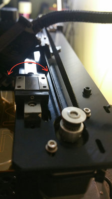

I noticed some play in my X-axis linear slider (in the direction of making the nozzle closer/further from the print bed, or rotational play) and was wondering if this was normal or not. I took apart the x-axis assembly and isolated it to the slider which still moves buttery smooth. I have had the printer since end of February 2016 and noticed lately the z-axis offset had to be changed all the time, even running the same material/print bed. The Y-axis does not have this play, so is it time for replacement?

I had a similar issue that you can find here:
viewtopic.php?f=7&t=3770
I went through the official support on the website and after quite a few troubleshooting back and forth's, we determined that my carriage was not seated well with the X gantry rail. Makergear sent me a pair that was pre-installed and confirmed to work within spec. Start with a support ticket and see what they say.

They sent me a new slider and that fixed the issue, no more play! I am still getting a slight vibration noise that is similar to the video in your post.
