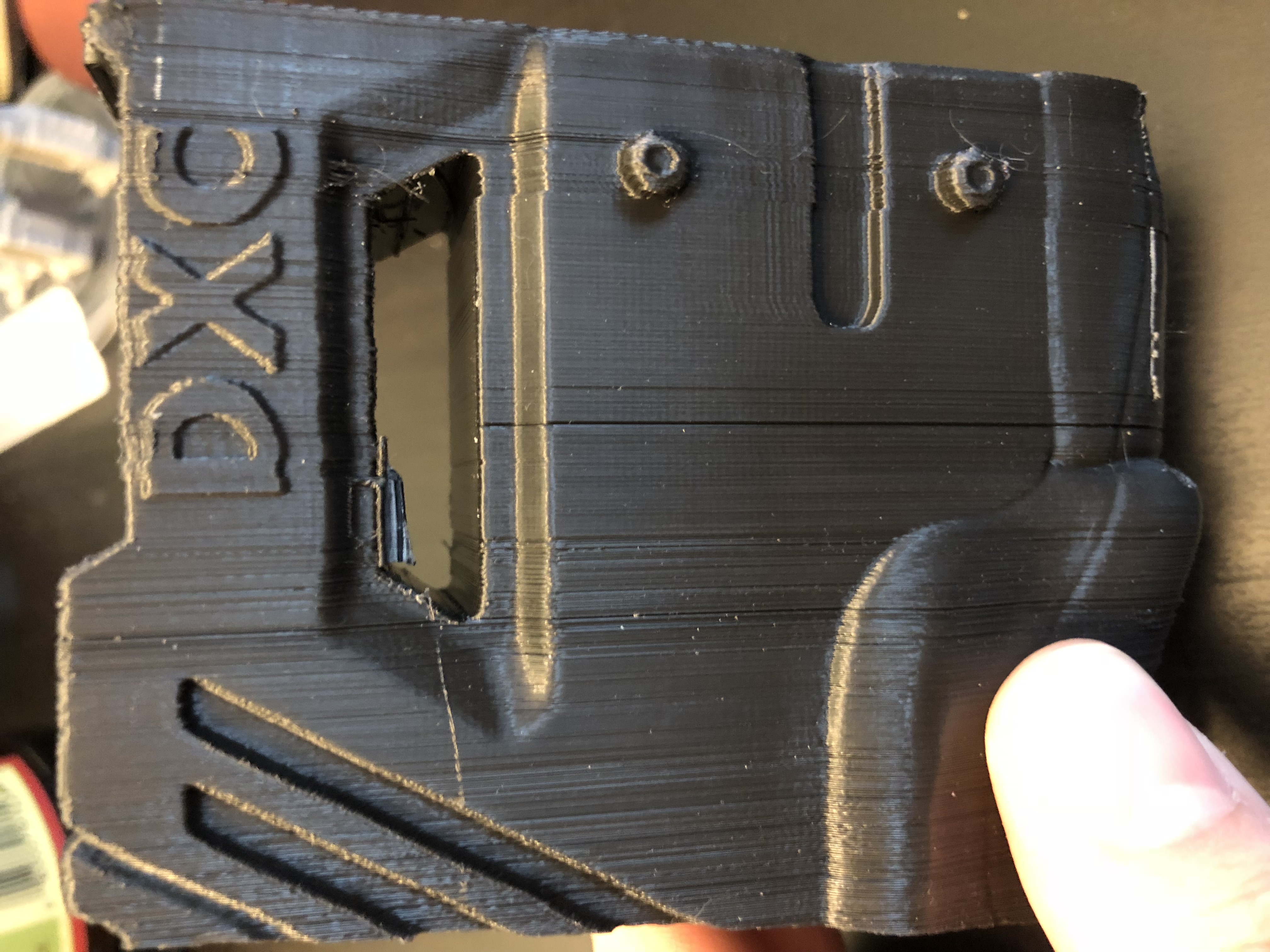

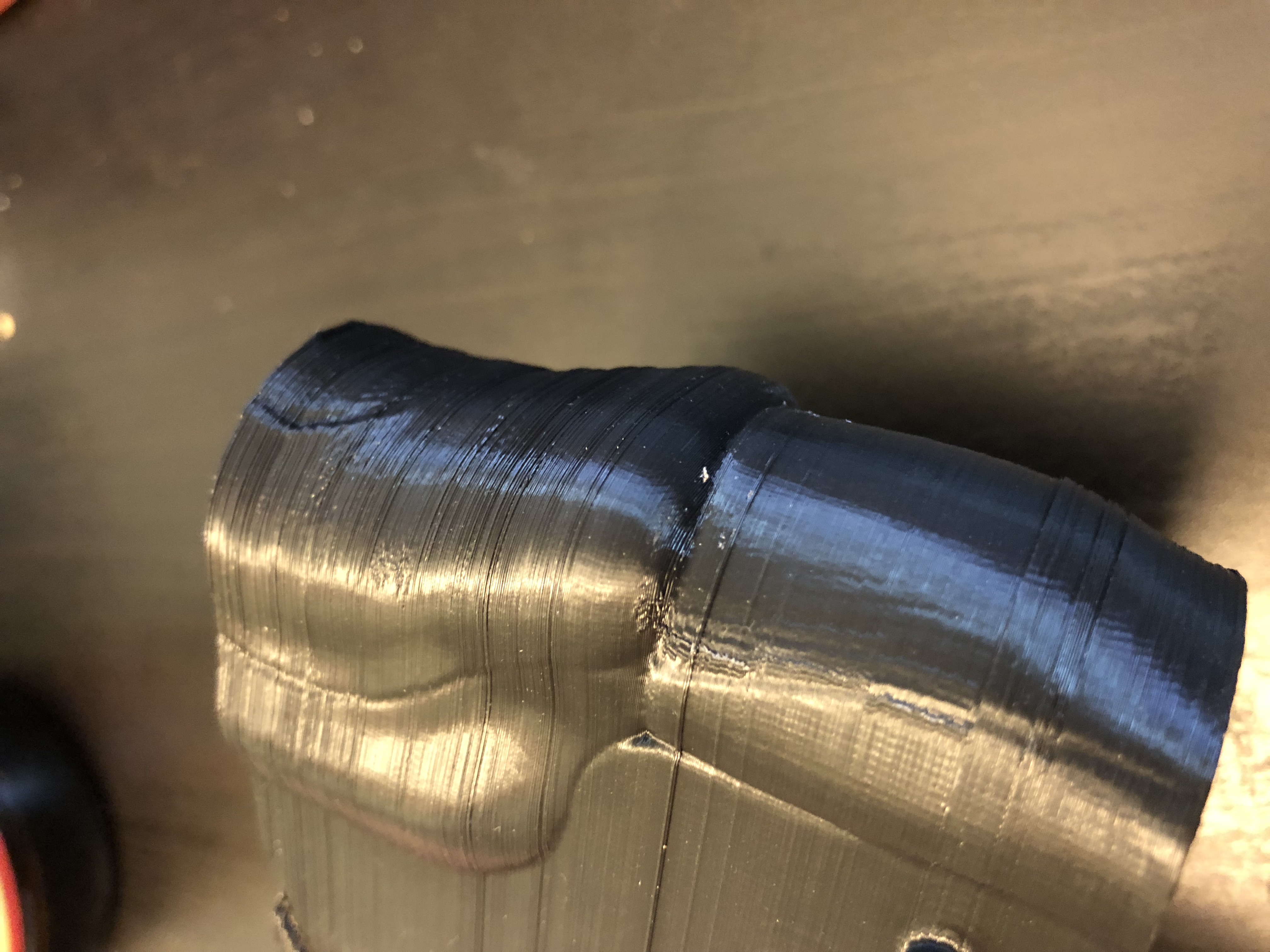

I think she's getting to that point where she needs a major tune-up. I've had consistent prints for about 2 years with her making numerous props etc. Lately, on the last 2 test prints my calibration cubes come out perfect but the prints themselves seem completely out of wack.
I've checked the filament, no change there, same OD
Extrusion seems ok, but the X and Y Axis seems to shift from layer to layer. The belts seem tight enough but I'm not sure if I should attempt to tighten them myself.
any thoughts from folks?

Judging from the model, though, the nozzle is whacking on raised perimeter threads after the part separates into two towers, along that steep overhang, when two towers rejoin into one, and at various protruding features here & there.
You're likely to see nasty perimeter curling at the corners in those situations and, with a big hunk of plastic stuck firmly to the platform, the nozzle impact can briefly stall either or both of the XY motors.
Set the slicer to squirt infill first, then add perimeter threads from the inside out: with a bit of luck, the infill will anchor the perimeter threads a bit better and reduce curling. If you have just one perimeter thread, a few more can help hold the outer one in place.
Aggressive cooling may also help, although reports from folks with exotic cooling ducts seems mixed at best. If it's PLA, you can't have too much cooling.
Some folks add a smidge of Z hop during layer changes, which probably won't help for a part with the nozzle traveling between multiple islands.
And, perhaps, after a couple of years, you're designing / printing more intricate parts which make the limitations of 3D printing more obvious ...

So i think this was a senior moment, i realized while looking up how to tighten the belts that the banana clips on the glass plate have been missing the past few prints... :oops: :oops: :oops: :lol:
Will be printing a few more things to confirm I was an idiot.
