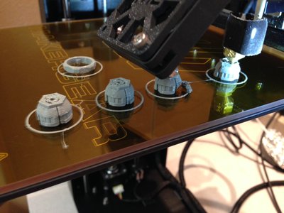

Looks like the main issue was stripped PLA bits and other remnants in the path of the filament drive. Cleaned the gear, replaced the drive, replaced the nozzle, and all is great. I think the remnants are why the "bite" mark tension test was failing to provide good results despite the perfect bite depth...
I'll try Insta's suggestion with a torch next week.
Big thanks to all the contributors of this thread and wealth of help in other threads!
Photo evidence of our success... except one small adhesion issue.
