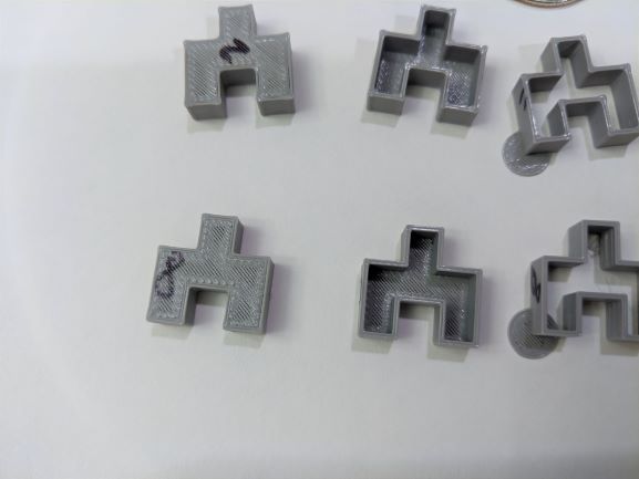

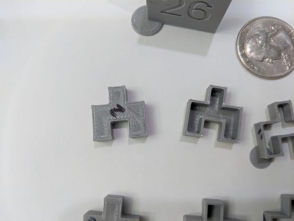

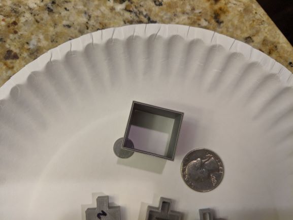

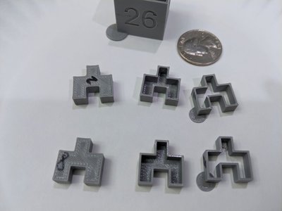

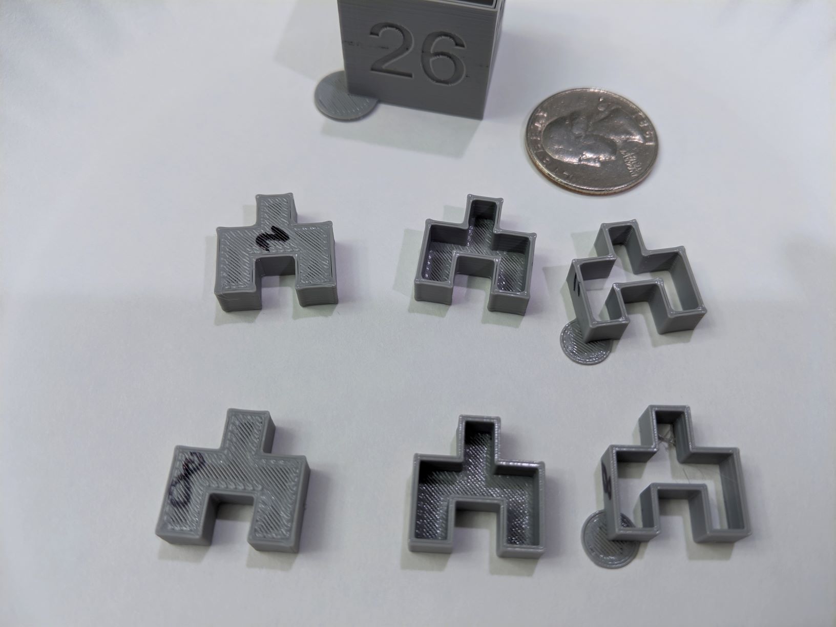

I have a hard time taking pictures, as there is no natural light in my workshop (all LED shop lights) and this time of year the days are quite short.
I took this this am in my kitchen with my camera set to "night mode"...
I don't believe the corner bulge I'm talking about here is related to the zaxis motion.
It is more to do with the relation of the extrusion flow and the X/Y motion.
I'm running an M2, 24 Volts, V4 hotend. I just run the standard 0.35mm nozzle, and am currently running Hatchbox PLA.
My default printspeed is 4800 mm/min. I normally do a 60% underspeed for the outlines.
The thin wall cube was small enough it triggered the separate de-rate for too short of a layer time, which put the printspeed down to 20% of normal.
The parts with a '2" on them are the typical results I get.
The parts with an "8" on them were run with the print speed slowed down to 20%.

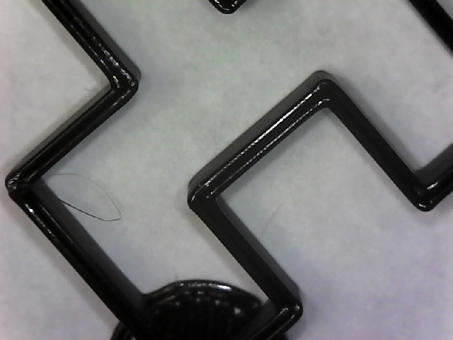

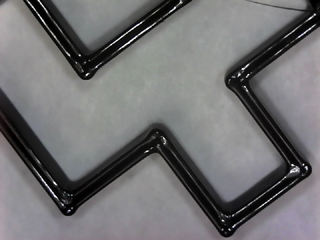

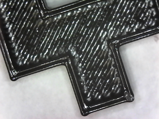

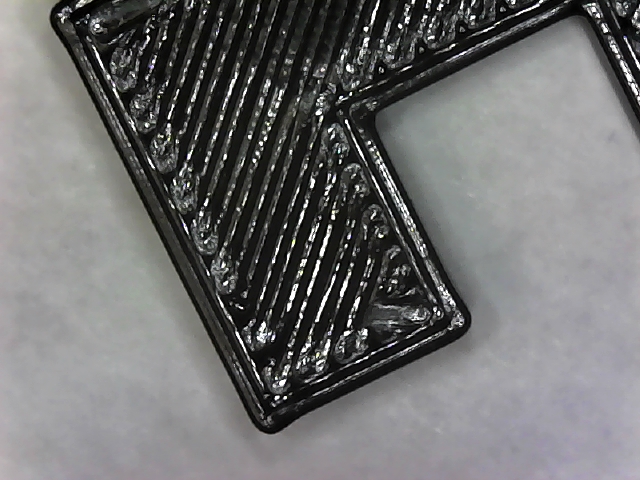

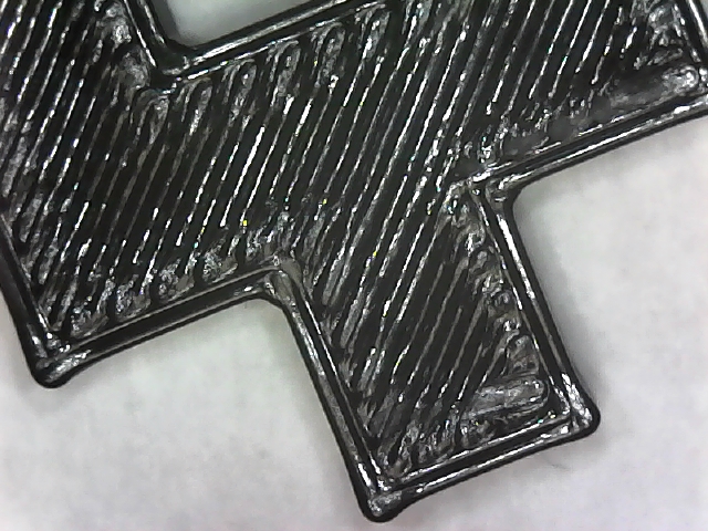

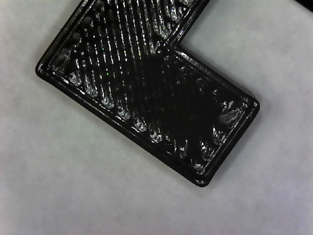

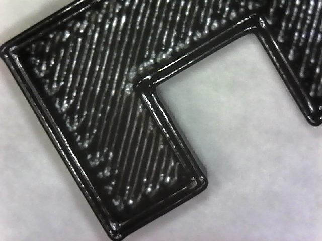

Well, if I did the math correct you are trying to print these tiny model as 80mmS .. You are getting the correct results.. Dragging a round squished molten plastic thread around a 90 degree turn at light speed.. They made a move about this.. Tokyo Drift.. :D
I will attempt to attach 3 sets of photos, each set of models was printed at progressively slower speed.
First was 50mms Second was 30mms and the Third is 20mms which is the speed I would have started with if I was printing something this small and I wanted it accurate.

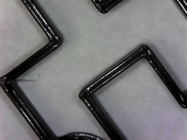

Posts: 605
Re: Corner bulging on 90 degree features in 2019
Post by airscapes » Wed Nov 06, 2019 3:59 pm

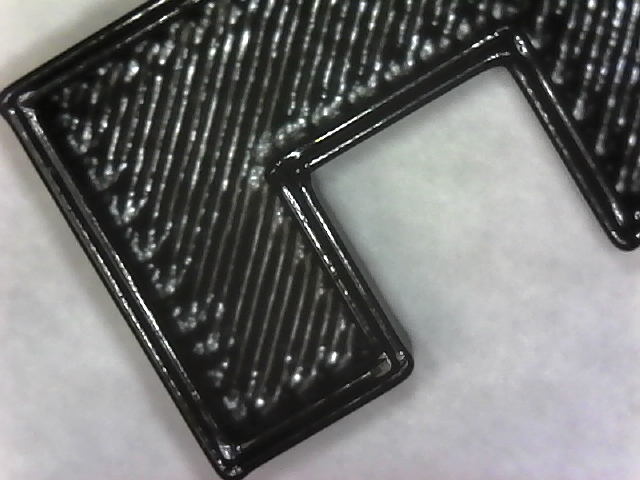

30mms

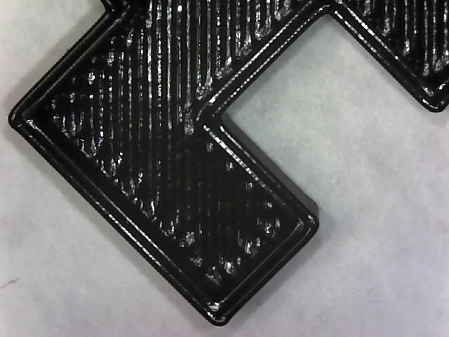

Posts: 605
Post by airscapes » Wed Nov 06, 2019 4:00 pm
20mmS

Two words will fix this, SLOW DOWN! :-)
BTW the photos were take with this cheapo USB microscope on the low magnification setting

The overall size of the part doesn't really impact the bulging corners directly. You get the same amount of bulge whether the part is the size of a quarter or the size of a dollar bill. The only caveat to this is depending on your acceleration settings, a large part allows the machine to get to higher speeds, and perhaps exaggerates the problem.
The impact on print time of slowing down is much more severe on a larger part.
These small test parts are just the smallest/fastest examples I could come up with that highlight the problem.
Let's say for example, I was printing a gear with a pitch diameter of 6 inches. I wouldn't want these blobs in two places on each tooth. Slowing down the perimeter print speed to 20 mm/sec will easily double the print time.
The car analogy is a good one. A race car doesnt drive the entire track at the speed it can take the slowest turn. Instead it accelerates and brakes to maximize velocity/minimize time.
