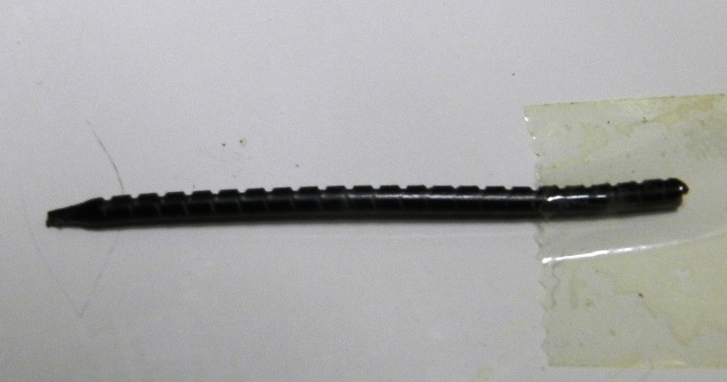

2k paper weight is only, because you're doing something way wrong.
PLA with stock settings using S3D is by far the easiest material to print.
Teeth marks from the drive gear should look similar to below photo:
Take liberties by adding stuff (washers) and messing with filament diameter that should read 1.75, not 1.73
and extrusion rates is where your whole deal went south.
That's for the experts here that have been 3D printing for a long time.
Head space between the tip and hot end works for me at .006.
Too close a head space and the hot end clogs itself.
Buy some feeler gauges at any auto parts store in case you do not have any.
Bed must be level, tighten it down to keep tension on the springs.
Use the stock settings, reset S3D to default M2 settings with the hot end your machine uses.
In my case with a April 2014 machine it's v3b. Then, in S3d chose PLA stock settings and you
should be good to go.
I'm not the sharpest tool in the shed, but if I can do it? ...anyone can!
