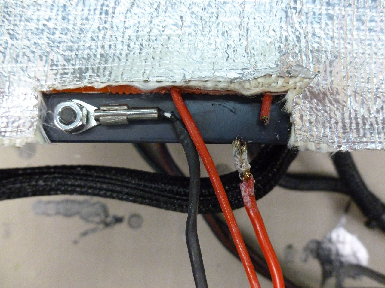

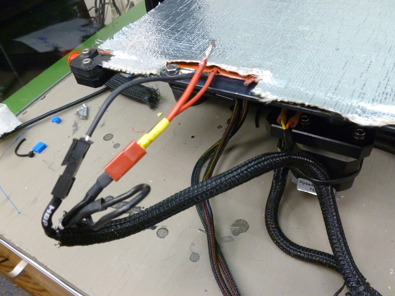

So far, the heated bed power wire has broken twice. After the wire broke the first time I lengthened the amount of cable between the cable tie on the motor and the HPB in hopes some more length to flex would solve the problem. It didn't and it just broke again. I've got about 1/2'' of usable wire coming out of my HPB now and i'm determined to find a solution while not having to purchase a new HPB. I'm thinking a cable track would be the best solution.

I've uploaded photos. You'll notice i've placed a thin layer of fiberglass insulation under the HPB to decrease warm up times.
Does anyone have suggestions or solutions that doesn't require drilling more holes and looks professional?

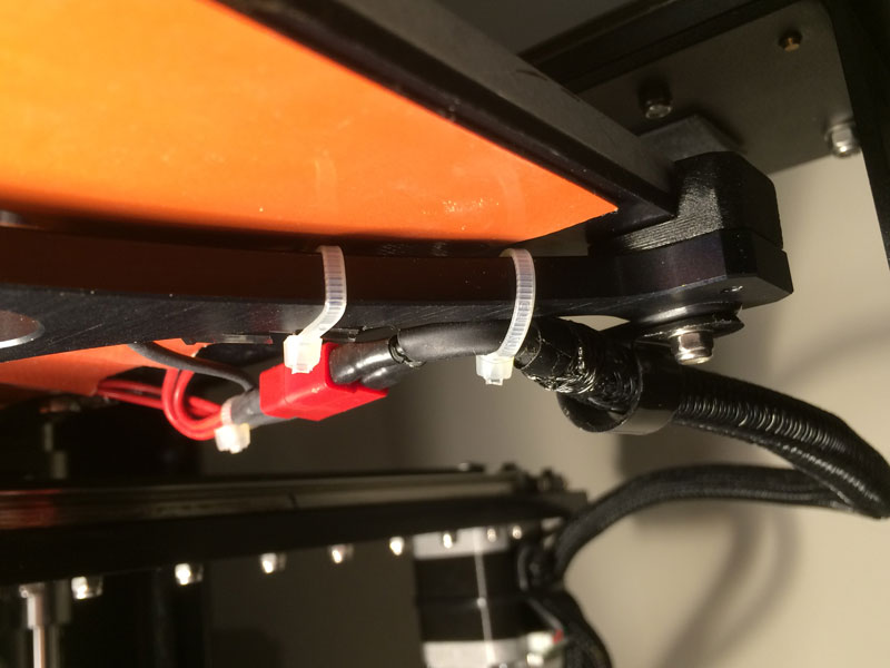

if properly secured there should be zero movement of the wires from the red plug to the bed. everything there should be strapped up so the only thing flexing at all is the black harness out the back. forward of that first tywrap nothing moves. its completely stationary. dont take your wires straight off the back of the platform. goto the corner of the spider like i have. the harness move nice big gentle sweeps with no kinking or actual flexing. it just rolls back and forth.

i bought mine as a kit and i dont know how the instructions say to run the wire but there arent many other ways to make it go that wont strain things over time. when i assembled it i left the wires out the back, moved the bed back and forth and right away knoew that wasnt really going to work
. i added the black plastic strap. i just took one of the longer screws from the left over hardware and used it in the corner of the bed corner rubber to let it stick through then just put a lock nut on it. it still moves there. thats just a support. the tywraps keep all the joints stable.

I know this is a really old thread but my HBP wire just snapped this morning, almost exactly like in the OP. I purchased my M2 assembled and the wire layout was as shown in the OP pic. It never occurred to me that it might strain and fail over time. Fortunately my colleague was able to solder the wire back together but I came here to look for a more long-term solution. Securing the wire to the spider piece is a great idea! Thanks jimc.jimc wrote:if properly secured there should be zero movement of the wires from the red plug to the bed. everything there should be strapped up so the only thing flexing at all is the black harness out the back. forward of that first tywrap nothing moves. its completely stationary. dont take your wires straight off the back of the platform. goto the corner of the spider like i have. the harness move nice big gentle sweeps with no kinking or actual flexing. it just rolls back and forth.
