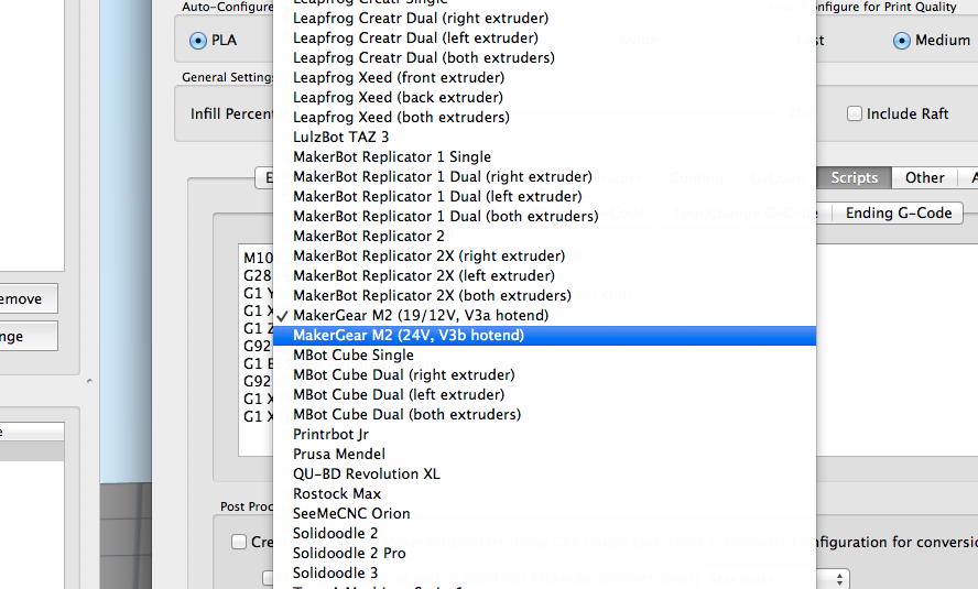

ok go back to the stock makergear profile. go into s3d and remove the current profile. dont save it. in the dropdown menu choose the profile for the 24v m2. load a test model and see what happens.

Post by jimc » Tue Aug 05, 2014 3:41 am
umm to my knowledge you can t overwrite the stock built in settings in s3d. you are removing the profile then choosing this one right?

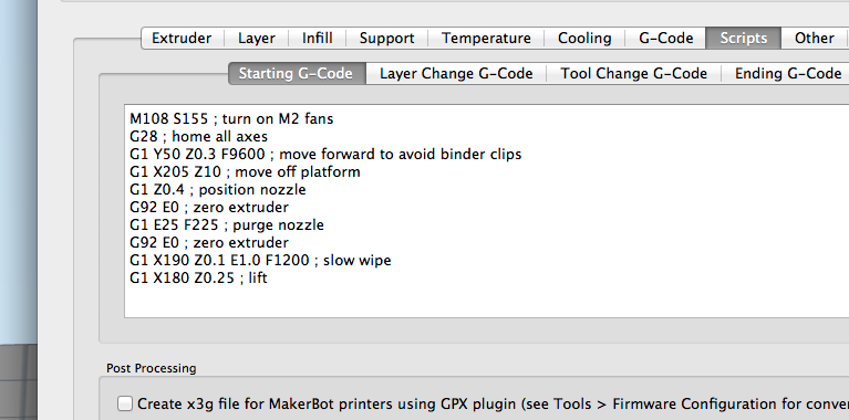

also the original starting gcode should look like this. confirm this is what you have.
Screen Shot 2014-08-04 at 10.32.48 PM.png (66.88 KiB) Viewed 24034 times
also just to double check, go into s3c machine control panel, take the "set fan speed" slider and move it all the way to the right. does the fan come on? if your fan is hooked up right then it should not. if none of this work i dont know what to tell you. there is nothing else in the process setting that will control your fan other than an M108 command in your starting gcode. S255 is full on and S0 is off. M108 is extruder and M106 is the bed fan.
